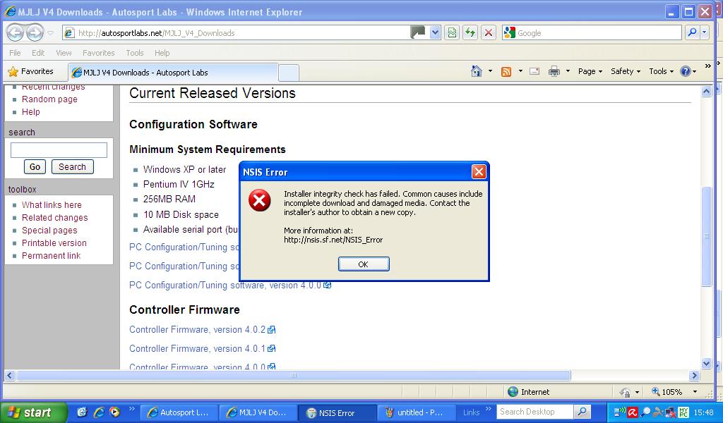

I've just tried downloading them again, and it's not working. I screenshotted the message and hopefully its attached.
This is the same for .1 and .2

- screenshot of error message
- sc sh.JPG (99.4 KiB) Viewed 22769 times
That is strange. I wonder if your copy of Windows or Internet Explorer is corrupting the download in some way.
Would it be possible for you to try the download on a different web browser - say Chrome or Firefox and see if that works.

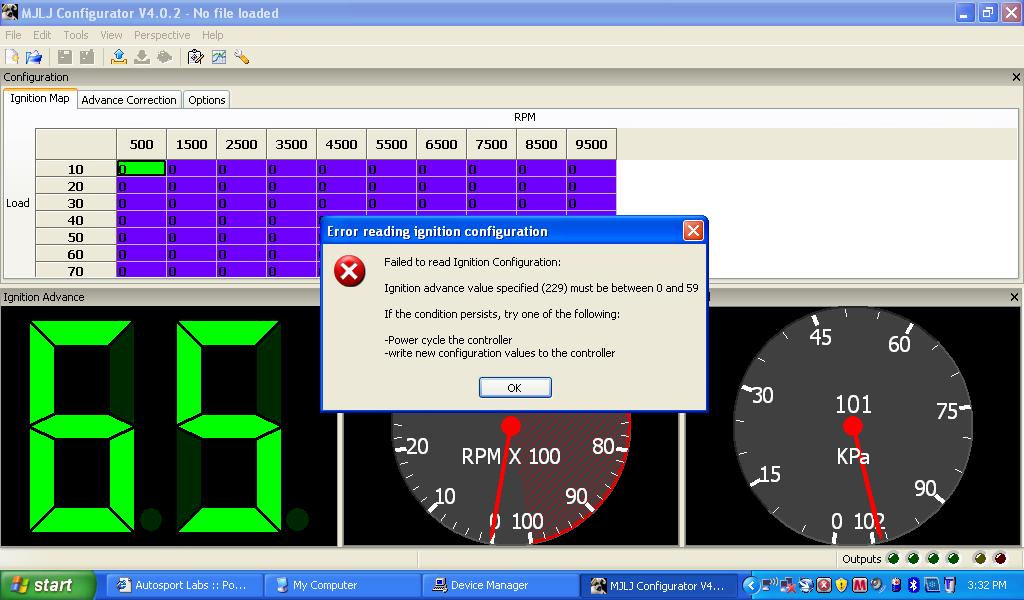

Connect it up, ignition on, and push the blue arrow, i get this warning message.
Theres a map on there, i know there is. I can start the engine, open a map, write a flash it.

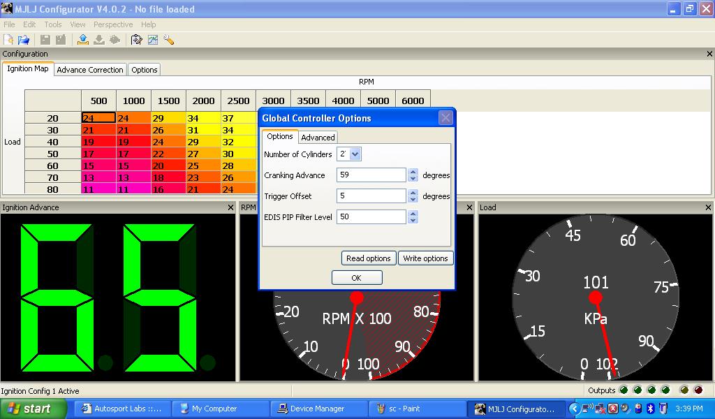

I've also just noticed this problem, in the next screen shot. It says 2 cylinders, and wont let me change it to 4, everytime i go back into it, its all changed back.

- warning
- sc.JPG (98.17 KiB) Viewed 22689 times
- clylinders
- cly sc.JPG (100.09 KiB) Viewed 22689 times
