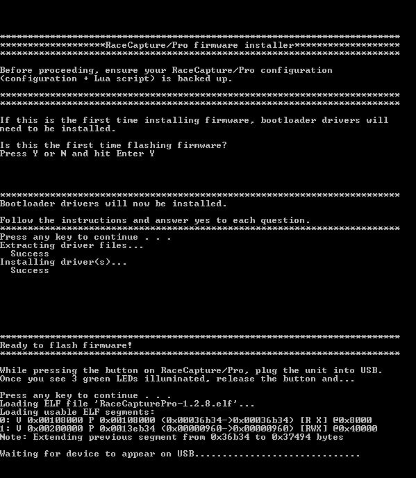

Is there a way to determine firmware version? I just got my unit a few weeks ago and I don't know what firmware came on it so I don't know which usb driver to use. I was going to go ahead and load the latest firmware just to be safe.
I have tried two different Windows machines with the same result.
It gets to the point of "Waiting for device to appear on USB........" and never moves on...
Based on what I read, the "flashRCP.bat" handles any drivers needed to communicate with the device or is that assumption incorrect. On the second machine I tried, I went straight to the bat file (didn't mess with any usb drivers first).
I answered y to "Is this the first time flashing firmware?"
I have one more machine to try on so I thought I would verify my assumptions before I continue on.

Given that it's not seeing the RCP after you install drivers, I think it's likely that it's running the older firmware and you need to install the older drivers to communicate with it. Once it's updated, you can then install the newer drivers. I've no idea how to check what firmware version you're running other than by remembering what you installed last!

I tried the V1 driver and it lets me install it. It then shows up as it should under the device manager on COM4.
RaceAnalyzer gives an "unknown error" though when trying to read configuration (and correct COM# is set).
I tried the V2 driver and windows doesn't seem to think it is applicable for the device so I agree that it probably has the older firmware.
Maybe I should first try updating to the latest of the old style firmware and see if I can get that to work.
I was under the assumption that when the firmware is being updated, it uses a different driver (not the one typically used for day to day use with RaceAnalyzer) If I try to update the firmware then the device shows up as bootloader or something to that effect. I had to go in and remove that driver to get it to show up the correct way.
Correct, when the system is in bootloader mode it uses a different driver. this bootloader driver gets installed with the flashRCP.bat installer script you'll find in the latest firmware download.
After the bootloader driver is installed, and you fire up RCP in bootloader mode (holding down the button on the unit) It should show up in windows device manager as "Autosport Labs bootloader" under "libusb..." devices.
Take a peek at device manager and let us know what you see in the list while in bootloader mode; we're especially interested if it shows any device or driver errors.

Unfortunately it does not show up at all under bootloader mode.
If I just plug it in normally (not holding button down) , then it shows as:
libusb-win32 devices
Autosports Lab Bootloader
This is also on a fresh machine.
I just ran the firmware batch file which of course installed the bootloader driver...then plugged in the RCP while holding down the button. It never finds it...
emailed you directly so we can dig in to it further via screen-sharing.
What I would want to try (while RCP is in bootloader mode) is delete the libusb bootloader driver (from within device manager - right click, delete), then re-run flashRCP.bat and see if it gets the bootloader driver installed correctly, so it can detect RCP and start the flashing process.
I have tried various ways... and whether I have it already in bootloader mode and install driver or if I have already installed the driver and then plug in RCP (with button down), the device shows up momentarily under "Other Devices -> Autosports Labs Bootloader" (with exclamation point), then after a couple of seconds, it goes away and shows up as "Human Interface Devices -> USB Input Device"
If I uninstall the 'USB Input Device" device, unplug and try again (in bootloader mode) it repeats the same thing every time.
I also tried deleting "USB Input Device" and then just rerunning the flashRCP.bat again and loading drivers. This does not seem to matter...it's always ends up (after a few seconds) a "USB Input Device".

Got your email.
In the meantime, while it is in bootloader mode, try manually installing the unzipped bootloader drivers to see if you get any further.
Also, while in bootloader mode, try deleting the driver completely in device manager, then re-install the bootloader driver and see if that makes a difference.
