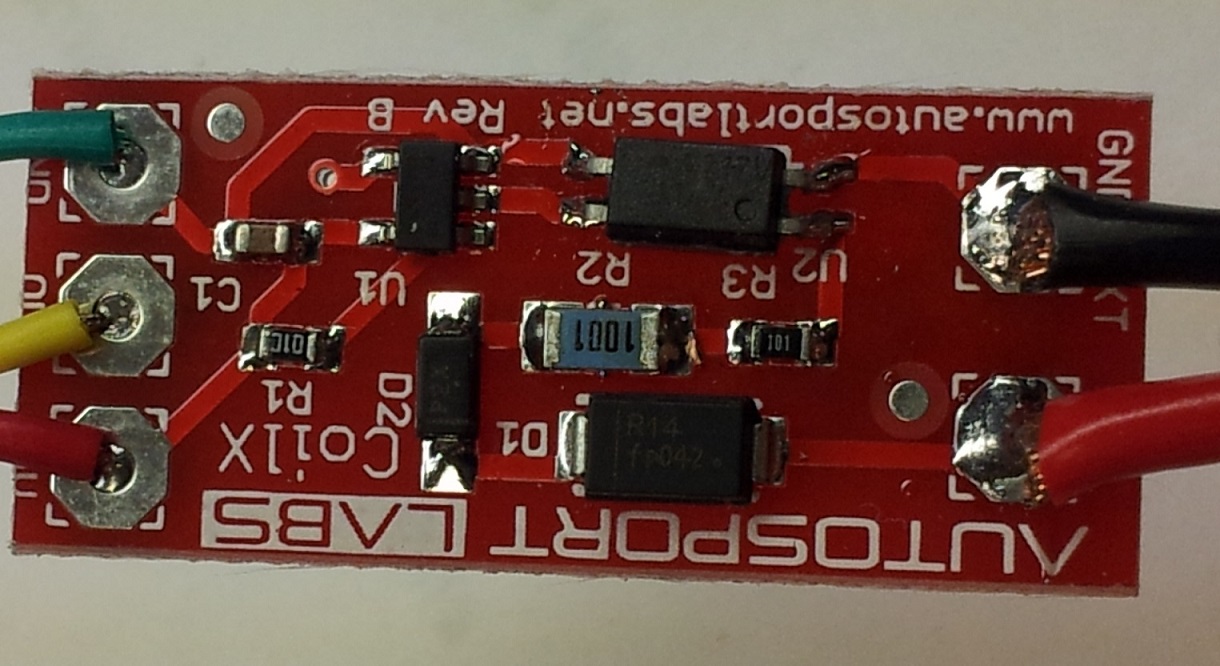

I got my CoilX in the mail and in the process of connecting the wiring to it, the U2 IC fell off the board. I re-soldered it, I believe in the correct orientation, and temporarily connected it to the terminal on my coil that is fed from the ECU and a ground point on the engine, then to the RCP as shown in the examples on the wiki.
It didn't work. I am not sure if that's because of my soldering skills, or lack thereof, or if the signal I am trying to connect to is not good. I may have access to an oscilloscope here at the office but I am not 100% certain and I have to be in a training class, so my time today will be limited.
I just wanted to open a thread so I can get a documented step by step troubleshooting guide together, if that is possible. I'm attaching a picture I just took of my CoilX in the condition it's in right now.
Where should I start troubleshooting?

Hi Jake, first step is to verify the board is getting 5v and ground as expected on the RCP side.
Then, using a scope, verify that the coil input is seeing that 400~ V high voltage spike.
Then, using a scope, probe the output and ground to see if you're getting a square wave output.
Then, using a scope, probe the coil input side working your way around the components you see going towards the opto isolator; D1, D2, R2, R3.
Become familiar with the theory of operation here so you understand how the voltage clipping and filtering works. http://autosportlabs.net/CoilX
let us know what you find out!

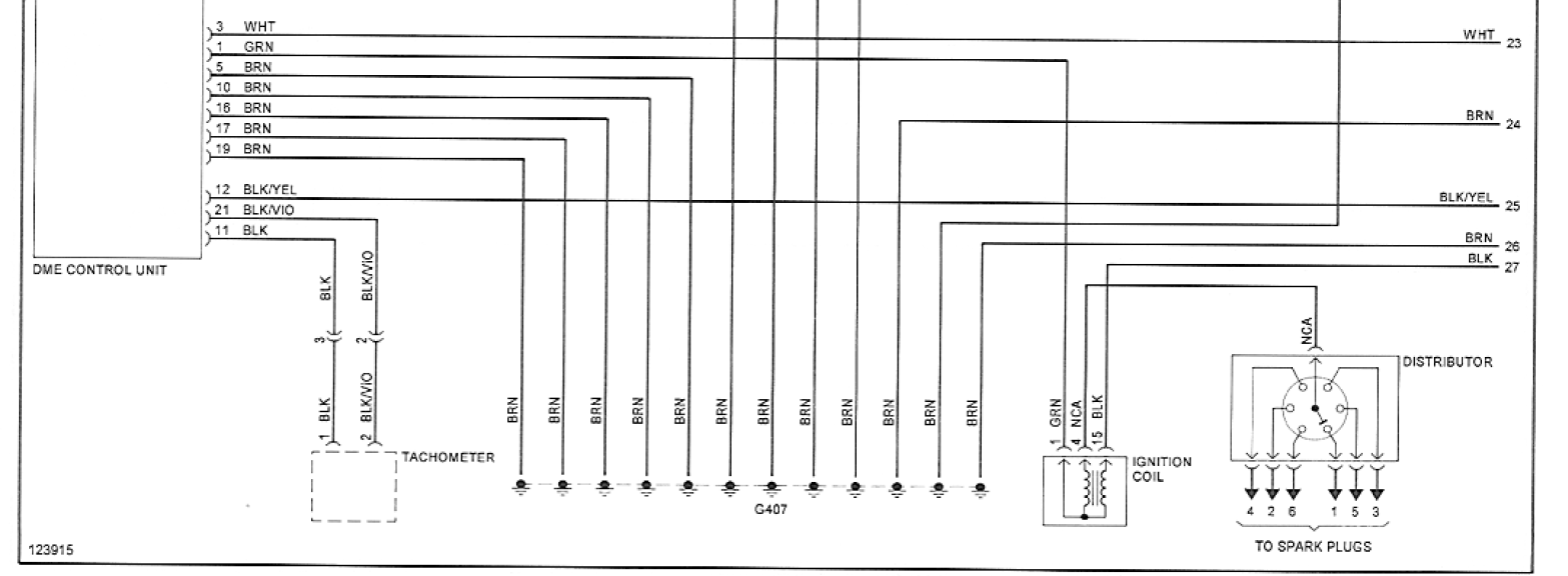

I had my car re-dyno tested this afternoon because they didn't give me the A/F ratio info I paid for, and I was talking to the technician there, he feels, based on his experience, that it is probably a software / configuration thing rather than a wiring issue, so I reconnected it temporarily with the wiring outside the car and tested again. These tests were done with the CoilX connected to the green wire from the DME to the coil, and the EXT ground connected to the nearest ground point on the intake runners. Diagram attached.
That is where I started tonight, and I see a solid 5V coming from the 5V reference and I also see that on the CoilX board.

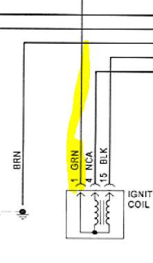

which connection in that diagram did you connect CoilX to on your engine?

I connected the input to the CoilX here where it is highlighted. If you look at the larger diagram, it is fed from the ECU.

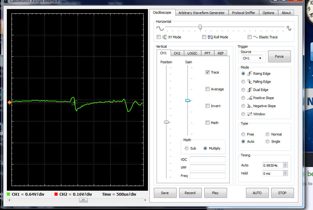

Okay, got home tonight and reconnected everything. Ohmed out all the diodes along the path and it seems like everything is cool. Hooked up the little Xscope and started at the input to the RCP, remembering that it's only capable of ~200V if it's lucky. Nothing there. Stepped my way to the board and wasn't sure which was the output of the optoisolator, so I went to the obvious input of the opto and found this: It's pretty small, but it's there and I don't see anything coming out of the 2 pins on the other side of the opto so I am removing it and going to go double check my solder joints with the microscope camera and see if I missed something when I reattached U2.

I figured out that U2 wasn't soldered fully. It works, but initially it showed 1/2 of the correct RPM on the android app, so I changed the pulses from 6 to 3, which corrected that, but when I look at the data on RaceAnalyzer, the RPM value is roughly doubled. I pulled it off again because I have to figure out how to route the cables, but it is functional now. There may be an issue with one of the apps it seems, though.
thanks for the update! Sorry you had to go through that due to a part not properly soldered. If you have screenshots of the ignition signal going into CoilX, that would be great to see here.
Also, try monitoring RPM again in both apps after power cycling RCP, there might've been an old config value stashed.
