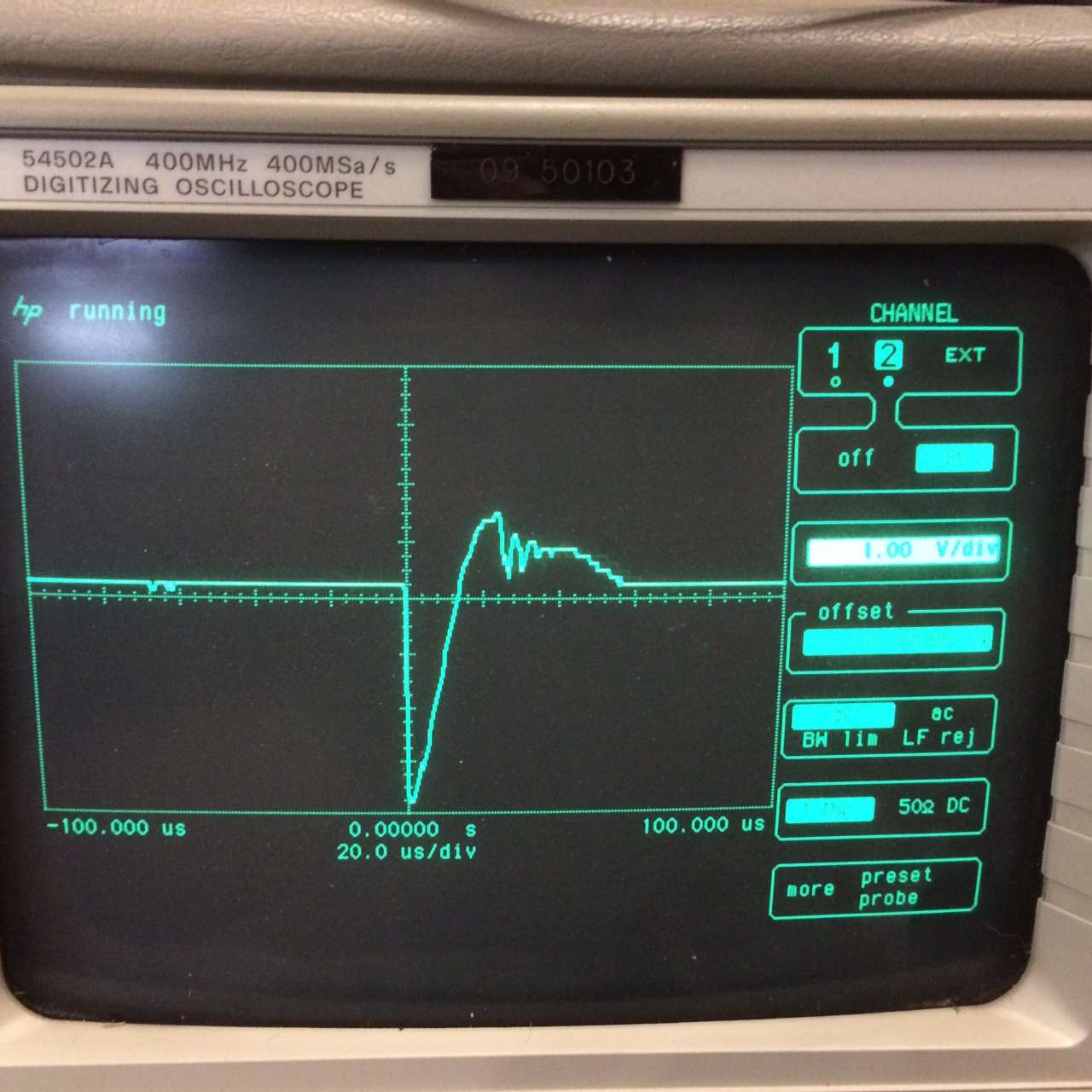

Here is an oscilloscope trace of the positive terminal of the spark coil used with a capacitative discharge ignition system, where the negative side is permanently grounded. The EE who took this had this to say about interpreting it:
Below are the ‘scope screen captures of Drew’s 911SC CDI ignition primary signal. Since I used a 100:1 input voltage divider, the voltage scale is 100X larger than shown to the right of the waveform.
•The vertical scale is 100V per major division.
•The horizontal (time) scale is 20uS per major division.
•Zero volts is slightly offset at 0.25 divisions above the center line (because I didn’t auto-cal the scope at the shop)
•Thus the main pulse is a -300V pulse that falls sharply, then rises to +120V nearly linearly over 20uS.
My EE friend thought that perhaps the peak signal could be that high, but beyond the resolution of his scope at the settings used. One of the characteristics of a digital scope, I gather. He tried to get a train of pulses to examine, but for some reason could not get ones with useful height.
Will the CoilX work its electronic magic on a signal like this? How about if the signal is the 460 volts Porsche lists in its shop manual?
I need a 3-5V signal I can use to count engine revolutions for testing transmission gear ratios for rules compliance. Your CoilX should work just fine for the various models which use the ECU to ground the spark coil. On the OBD cars I can get the spark signal from the OBD port. But these CDI models, from 1969 through 1983, are very popular as race cars in a "stock" class, so they are now the last piece of the puzzle.
What do you think?
What do you think?

Thanks for that. The CoilX module might work; if you look at the theory of operation here http://autosportlabs.net/CoilX It shows how it will clip everything below 75v, and it also will block the reverse pulse as well. If 75v clip is too low, we could try a 100v clip to only trigger on the peak of that flyback pulse.

The large spike is negative, isn't it? Or is that an artifact of a scope setting? The goal is to have only one signal come out of the optoisolator I gather is at the other end of the circuit, and is what makes sure only a 5V or smaller signal comes out.
Is the flyback pulse the positive "ringing" after the larger negative pulse?
How would I raise the 75V threshold to 100V?
If the input leads were reversed, would the large spike be seen as positive? Then all of the ringing would be seen as negative and discarded?
The Schmidt trigger squares things up, though for the microprocessor where the signal will be counted that apparently isn't all that important, though it doesn't hurt. On getting a voltage the microprocessor stores it as a count, and also waits for a set time to look for another count. In my application we are looking at 800-1500 rpm. Even at three counts per revolution, that is a low frequency so using software to filter I gather is a good technique.
And I plan to use the CoilX on a number of Porsche models which have the ECU ground and open the coil primary negative, as in the traditional Kettering ignition - the 944s being a family which all have an ECU do this, and the 1984-89 3.2 Carreras being another. It would be convenient if I didn't need one CoilX for one use, and another for another.
Yes, that's the flyback pulse. There's a Zener diode that clips the signal at 75v. Changing it to 100v means using a different part. We've been thinking of altering the design to just use the 100v part since all of the coil flyback signals we've seen exceed 100v.
Re: reversing the leads - which coil terminal did you probe again? see what the signal looks like for each terminal on the coil pack.

We probed the coil positive. The coil negative, when probed (we were initially uncertain which was which, as the coil was mounted on the car, faces sort of down, and has a rubber protective cap over it), didn't seem to show much, if anything. I wouldn't have expected anything, since it is hard wired to ground, but you know more about that kind of thing than I do.
On this Bosch coil positive is indicated by an A. The coil negative is indicated by a minus sign. At least looking with a mirror showed these. The A might have also had a plus, and the negative a B. Other Bosch coils have 15+ and 1-, as well as a 4 to indicate the secondary spark wire to the distributor, all under the standard German wiring numbering system.

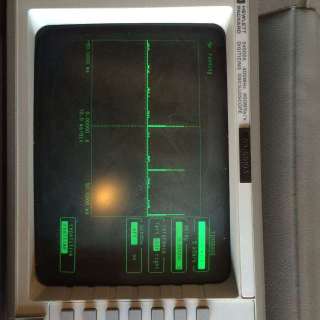

Brent - I tried the CoilX on a Porsche 911 3.2 liter Carrera. It uses the ECU to open and close the ground of the coil. The first data capture worked perfectly. But thereafter the data was junk - lots of missing counts. Attached are a scope picture, and - if it will send - a video. Oh, oh - file too big for video. Color me baffled, as while the CDI system has mysteries, the ECU control should be much like Kettering designed, just electronic "points" so to speak.
- mackin 3.2 missing pulses smaller - Copy.jpg (10.03 KiB) Viewed 22071 times
