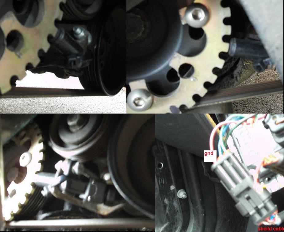

I'm not trying for any spark. I just want to see the rpm moving on the megajolt software.
I've attached pictures of the setup. I am using electrical plastic connecters like on the pic on all the wires.
The shield on the VR sensor has been checked and is ground.
I have swapped VR sensor cables back and forth several times.
The PIP/SAW cable pass the continuity test on volt meter. It passed at the electrical connector and as the EDIS end too.
P.S TPS is unconnected.
The VR sensor cable is shielded right up to connections. Cable length just over 2 metres.
I spent two hours this morning and "fail". I just saw the RPM signal flicker to 500rpm to 700rpm for a second or two then was dead after that.
Is the gap between the sensor to the wheel to small? It's very close. The pulley it is attached on is 5-6mm away from the sensor. Maybe it is detecting metal all the time? I doubt it though.

You can try whatever you like, but as long as you are not doing the one and only test that shows if your basics are ok you are barking up the wrong tree. So disconnect the MJ, hook up a set of earthed plugs to the coil pack, start the engine and see if you get sparks. If that works you can move on, but not before you have this fully functioning. Is it 100% sure the Vr sensor is connected the right way around? The VR sensor looks ok. The chance that it is constantly sensing metal is next to nil. There are people who have used very fine toothed 72-2 trigger wheels inside the dizzy without a problem. 6mm distance to the pulley is more than enough for getting a good signal.
