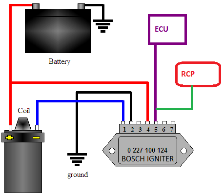

I have recently installed RCP into my 1989 Porsche 944 S2 and the GPS and accelerometer are working and logging fine. I tapped into the signal from the ecu to the ignition module for the RPM signal. Just plugging this into RCP directly doesn't provide a signal. Using a diode (anode end in RCP) I was able to see correct RPM in the sensor monitor. If I start a log right after that I get an RPM signal in the log. If I wait sometime without changing the configuration or plugging in the laptop, I don't get the RPM signal in the log. Plug the computer in again and it seems to work. I'm not sure what's going on and unfortunately I have not been able to measure the signal with an oscilloscope. I think it might be a 12v square wave so I used the diode to block the positive end but allow the 0v signal to pass to RCP. The ignition module is a Bosch unit that I am somewhat certain is using a switch to ground signal to trigger the ignition coil. If I need to just use the CoilX I can but if I can do without that would be nice since I have an autocross coming up soon.

The other option is to tap directly into your ignition coil trigger wire (-) by using the CoilX module:

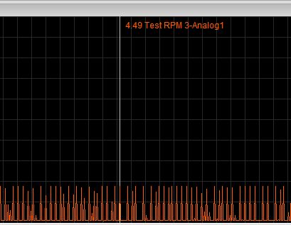

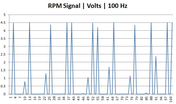

Here is a picture of the signal trace. I recorded this via an analog input at 100 Hz while the engine was idling at approximately 840 RPM. The first trace is from the data points I exported to excel to focus on a smaller section of running, the second is as shown in Race Analyzer.
What I think might be happening is that since my ECU grounds the signal when not triggering the ignition coil (verified with voltmeter when key on, engine off) the RCP unit is faulting that port since it usually has a default of positive voltage (5v pull-up). Does this sound like it might be an issue? Is there a way to switch the unit to a pull-down for the RPM signal?
- 944S2 Idle Ignition Signal.JPG (30.9 KiB) Viewed 24285 times
- Raw Idle Signal 944 - 840 RPM.JPG (45.34 KiB) Viewed 24285 times
