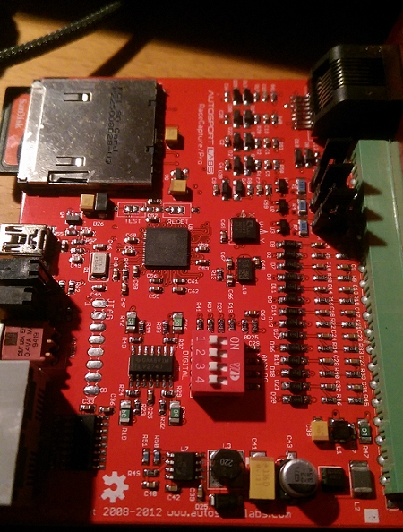

RCP: mine (photo attached)

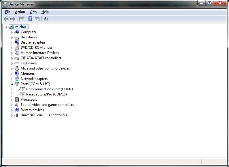

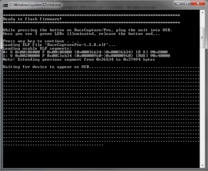

It's not working ...
When I have 1 led Windows Device Manager shows COM10 and when connected under 3 green leds nothing.
I tried v1 and v2 and to no avail.
What do I do next?
attempt to connect on firmware 1.2.8_25m_later.png (30.15 KiB) Viewed 52727 times

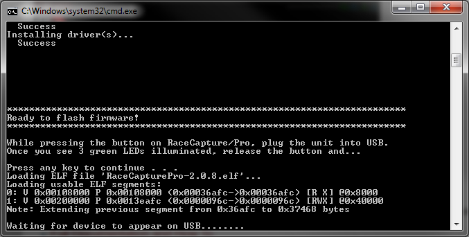

attempt to connect on firmware 2.0.8.png (27.22 KiB) Viewed 52727 times
Device Manager 1 green led.png (54.67 KiB) Viewed 52727 times

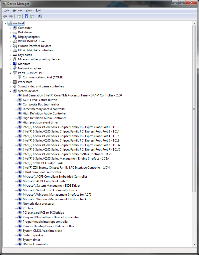

Post by MichaelDrost »

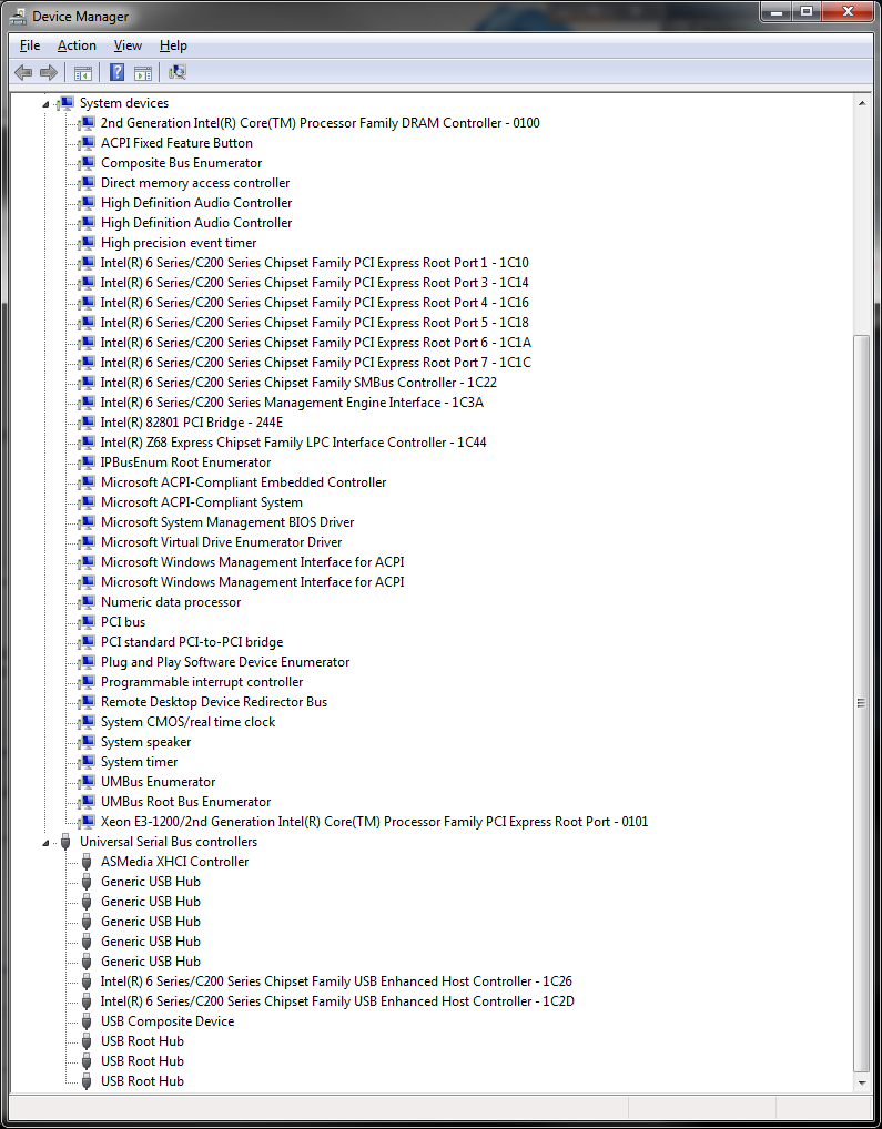

as requested.
No AutosportLabs" bootloader under the "libusb" branch of Device Manager visible (yet).
Am going through all driver properties manually.
And Brent? Thanks!! I really appreciate your help!
Michael
Schermafdruk 2014-09-29 19.23.32.png (115.15 KiB) Viewed 52714 times
Schermafdruk 2014-09-29 19.23.37.png (115.6 KiB) Viewed 52714 times

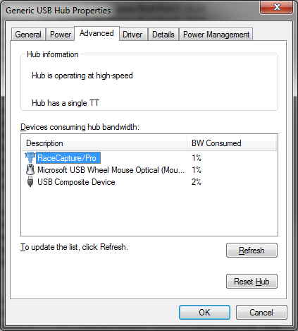

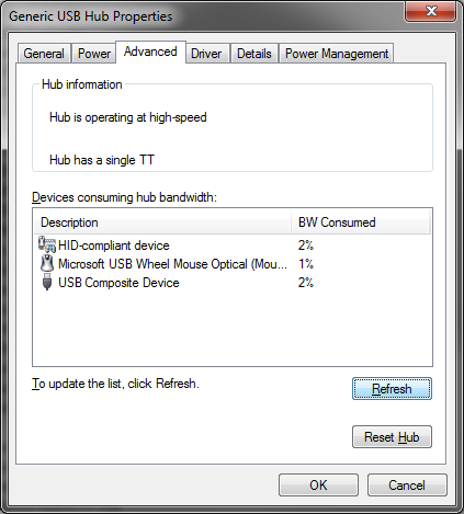

Right, I've found the USB Device location and ran a "1 led" and "3 led" test.
See attachments.
Other than that, I am still clueless. Could de-installing and cleaning out the registry (regedit) help?
Thanks for all help so far ...

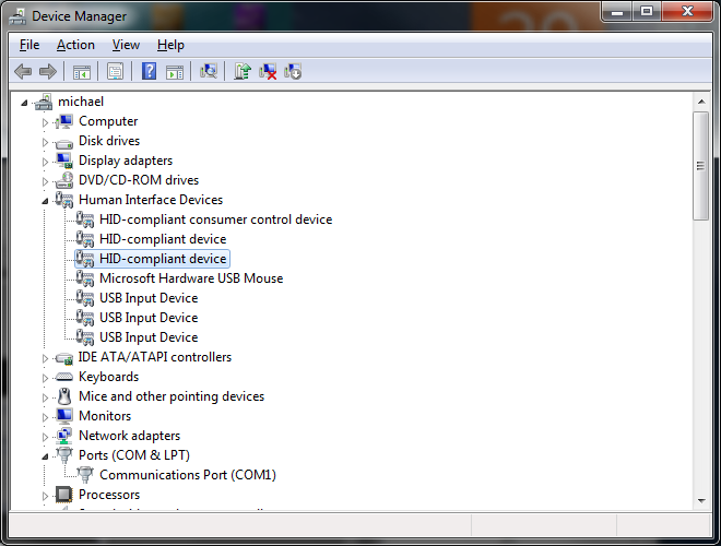

Found "three led"setting under "Human Interface Devices".
Every time I connect in 3 led mode an additional HID device appears.
Every time I connect in 1 led mode RCP is recognized as a USB device.

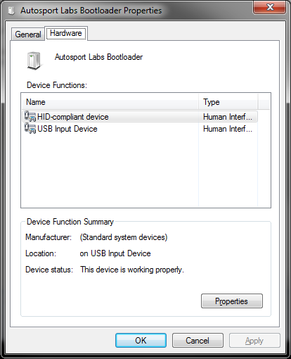

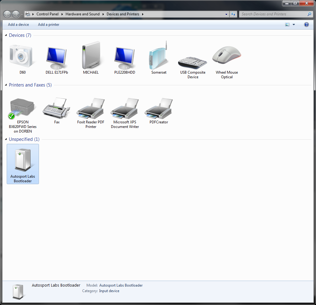

Found this under "Devices and Printers" (in 3 Led mode)
Unknown device "Autosport Labs bootloader"
Recognized as USB input device and HID Compliant ....
2014-09-29 22.07.20_bootloader.png (28.76 KiB) Viewed 52678 times
2014-09-29 22.07.11_under_printers.png (139.85 KiB) Viewed 52678 times

Right, it seems Windows has ID'd the RCP in 3 Led mode as the Autosport Labs Bootloader, but for reasons unknown seems insistent on referring to it as a HID device, rather than a USB device.
I have a Windows XP laptop, so I'll give that a try to, but that will be tomorrow.

Got it to work on my ancient laptop (which is why it took so long before submitting an update). So I am saved!!!
