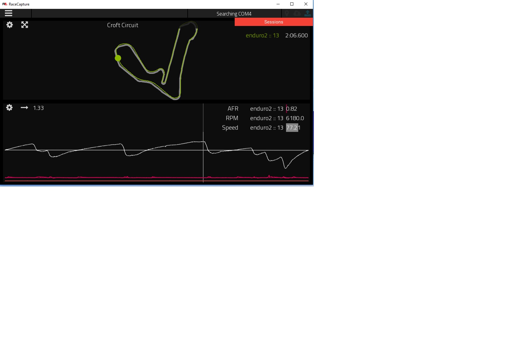

I am also having this problem, AFR and rpm appear as nearly flat lines but the speed is ok, I have installed version 1.9.0 but I still cant see a way of altering the scale? has anybody got any idea if I can alter this

HI the rpm is set to min 0 and max 8000 and the AFR is 0.5 to 1.5, the innovate gauge is programmed to the same so lambda 1 is 1 volt output, then I can just read the raw values as lambda
So, just to be clear; when you import the data, are you seeing your values change, but the scale is incorrect in the charts? Just want to ensure that what we're planning on will address your issues.

yes that is correct the data is there, I can see the figures changing but the chart is almost a straight line

There's a task to provide an interface for adjusting all of the min/max values for the channels in the app.
Until that is available in a future release, you'll need to re-import the data after editing the log file in a plain text editor (do not use Word or another word processor). You can edit the min / max in your original file using this reference:
https://wiki.autosportlabs.com/RaceCapt ... _reference
You'll also want to go edit all of your channels to ensure future data logs are created with the correct min/max values.
Thank you for your patience, we'll work to make this easier in the future!
