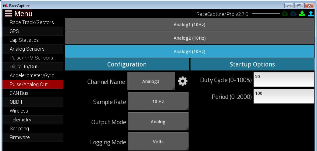

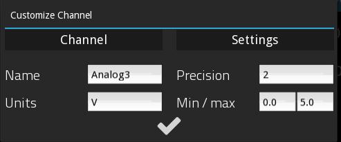

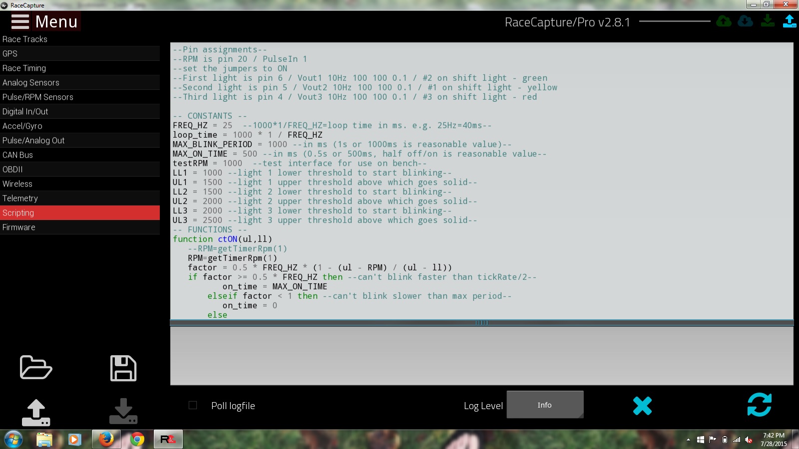

Hopefully someone can show me what I am overlooking. I recently installed my shift x light and loaded this script into my MK1 but am having an issue. As soon as I turn the key and my MK1 gets power all of the lights on the shift light turn on and are solid.
I opened up the unit and changed the dip switch to ON for 1-3.
I turned on the Analog outputs ( set at 10HZ, Analog, Voltage)
Changed --RPM=getTimerRpm(0) to --RPM=getTimerRpm(1) since it is input 1. (Should this stay (0)?)
analog output setting
Shift light script
Shift light script

Ls_Rx7 wrote:Hopefully someone can show me what I am overlooking. I recently installed my shift x light and loaded this script into my MK1 but am having an issue. As soon as I turn the key and my MK1 gets power all of the lights on the shift light turn on and are solid.
Depends on which pin you are using. Please see the comments in the script, the script is configured to use pin 20 for the RPM input and wouldn't require any changes if you were using that same input pin for your RPM signal.

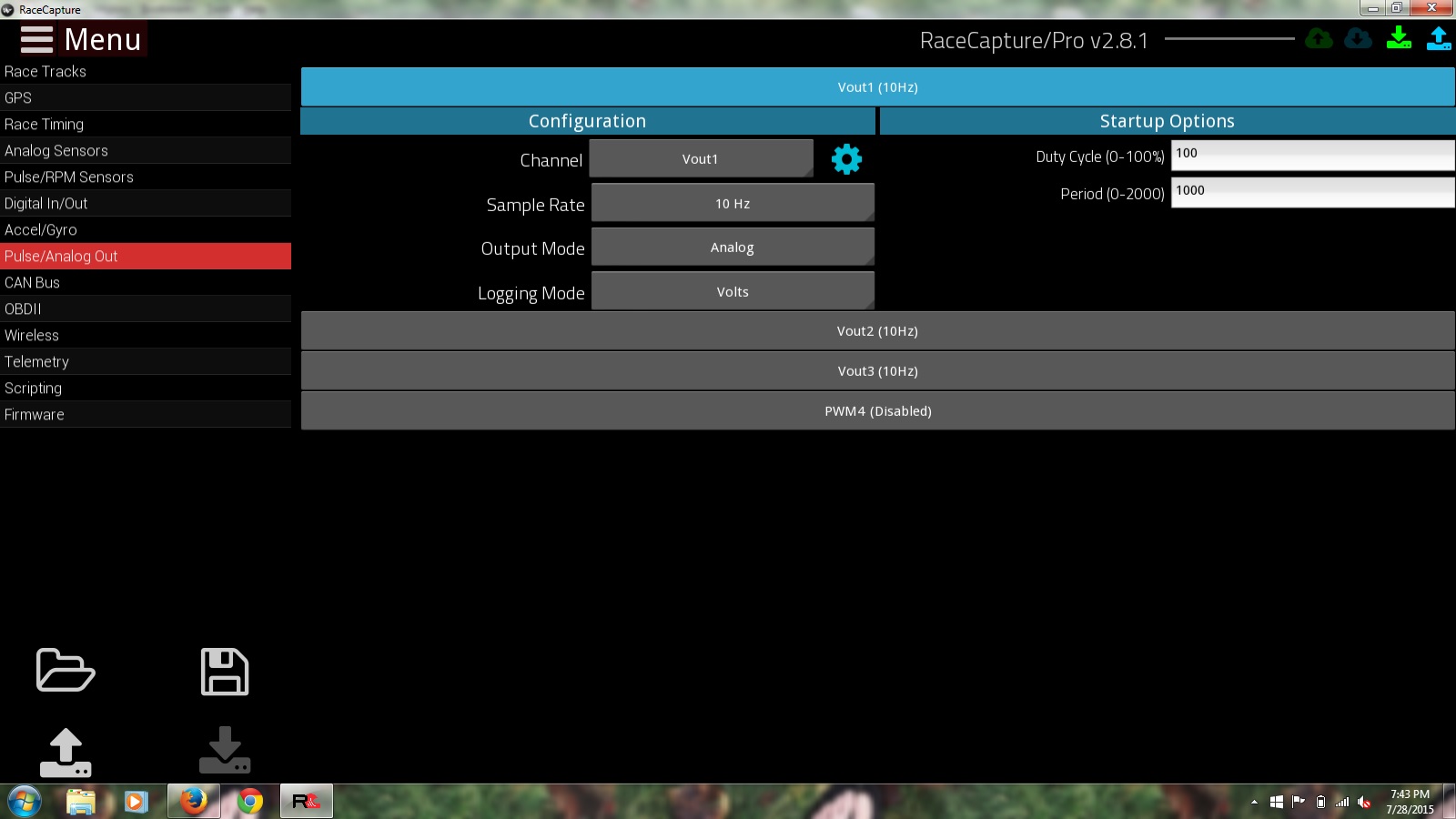

I changed the script back to what you originally had and verified I was using pin 20 for RPM. My shift light works but the lights are reversed. They are always on and turn off at the RPMs commanded. I am new to coding, what do I need to do to switch the lights so that they are normally off and only come on when the commanded RPMs are met?
EDIT: I think the script is fine. The issue is when all 4 wires of my shift light are connected the shift light turns on all lights even without a script loaded.
GTIspirit
Posts: 249
Location: SE Michigan
Post by GTIspirit »
Ls_Rx7 wrote: ...My shift light works but the lights are reversed. They are always on and turn off at the RPMs commanded. I am new to coding, what do I need to do to switch the lights so that they are normally off and only come on when the commanded RPMs are met?
Hmm, here's my config:
Sounds like your settings are somehow inverted. I tried disconnecting the 5V supply and that didn't replicate the behavior, so I'm not sure what it could be.
@gizmodo, I remember having that problem too when using the GPIO channels, that the behavior was initially backwards from what I expected, so I had to reverse the one and off settings. Same principle would apply to the analog out, except that wouldn't affect the behavior when no script was even running.....
I believe the way the ShiftX works is the 5V supply from the RCPro unit to the V pad on the ShiftX provides power for all three sets of lights. If the signal for say the green was high, and high should be ~5V, there would be no potential difference and the light would be off. If the signal for green was pulled low, to near zero, there would be maximum potential difference and the light would be on brightest. Hence my comment in the script file regarding the voltage setting which at first glance wouldn't make sense.....
&amp;quot;Startup Option&amp;quot; only affects behavior during bootup, or initialization, as I understand it.
&quot;Startup Option&quot; only affects behavior during bootup, or initialization, as I understand it.
Detailed channel settings.
