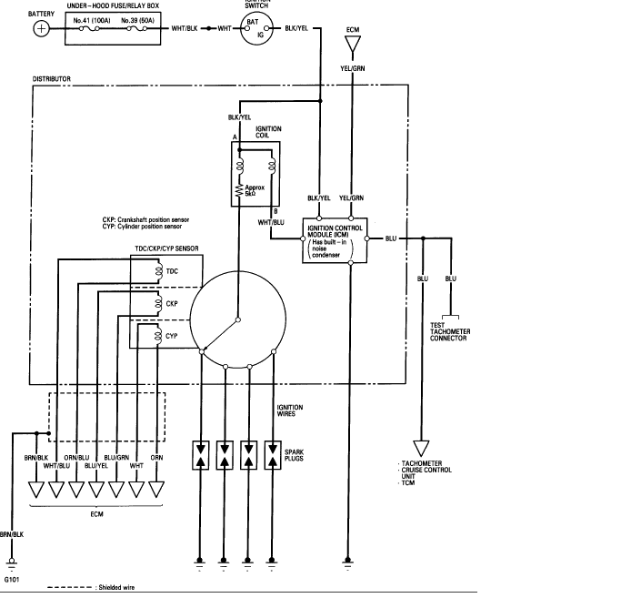

Hi guys,
I'm trying to get a RPM signal for my RCP. The car is a Civic with a B16 engine with a distributor. What wire should I get the signal from?
I have a CoilX on hand if needed.

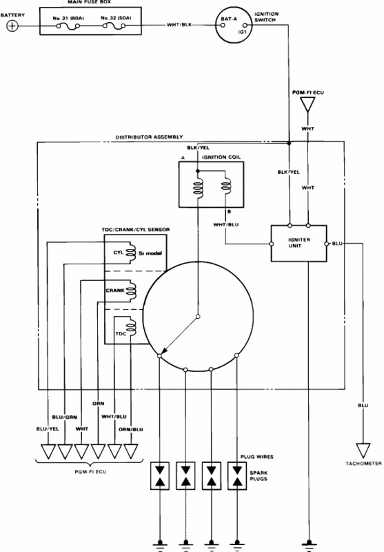

I'd first try the white wire connected to the PGM-FI ECU (upper right of the diagram).
Do keep us posted on this!

Thanks Brent,
First, I had the wrong distributor wiring.
I have tried with the YEL/GRN and BLU, but RCP reads 0. On both test, I had the coilX installed. I tried the BLU test straight without the CoilX, but no change.
I have a tach tap in the BLU that works fine.
Voltage on both wires is 10.5v, there is no peaks that I can see on the multimeter, I don't have a scope yet.

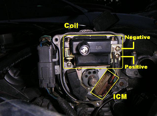

Should I try to get to the WHT/BLU from the COIL to the ICM in the distributor on the negative?
Inside Dist.png (122.29 KiB) Viewed 15086 times
* try yellow/green without CoilX. That might work.
