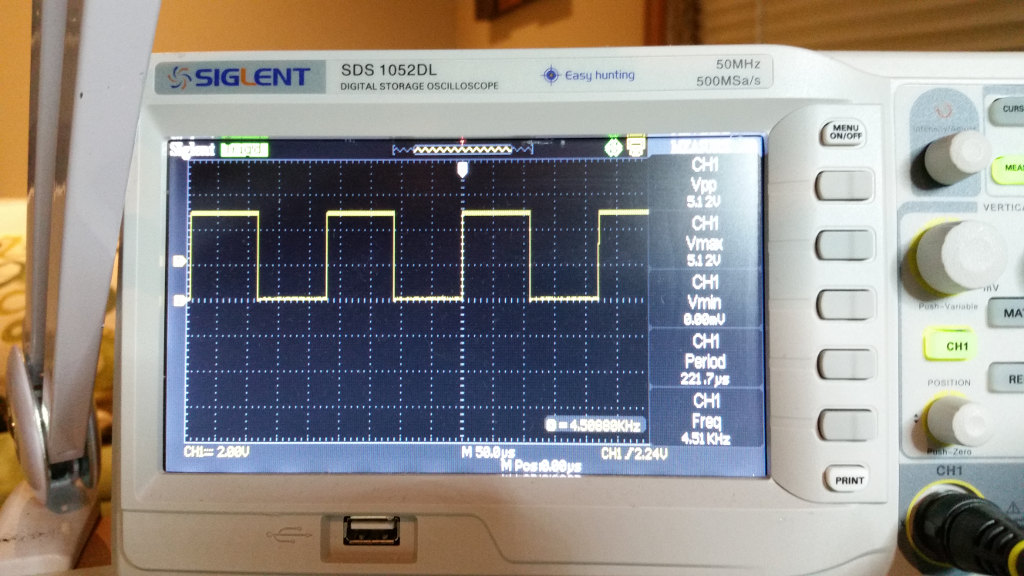

I'm dealing here with Borg Warner turbine wheel speed sensor. It makes nice square 50% 0-5v pulses (osc verified) at frequencies up to 4500Hz. So I'm using fast mode while turbo is at idle and numbers it shows make no sense. At this time osc shows 100hz and rpm shows nothing like that...

This is how it looks for me as well:
My particular compressor would choke above 4083Hz.

Yes. Re-created the setup using a 5v square wave and a sweep of frequencies.
Observed accurate results using the settings: Medium / frequency / 1 pulse per revolution. Video demo:
https://www.youtube.com/watch?v=tX9ALqI26WU
If you can, please try re-creating what you see here in the video. Stick with the medium speed: Fast was yielding a measured frequency that's 1/2 of actual; slow is yielding a measured value that's off by a factor of 10. Will log a bug to fix targeting 2.8.8.
