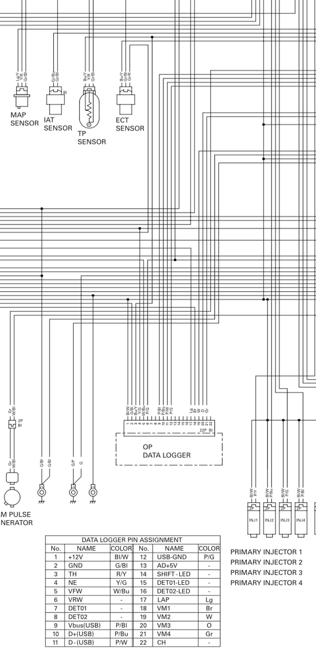

I've attached the a subset of the harness blueprint to show the TPS connection.
This is on a 2010 CBR600RR.

Just running the RCP playback while looking at the TPS trace and BATT trace (even though it's offscale, the numbers still show) it's obvious your battery voltage is dropping some during your straights. It's still over 14, so the engine will run fine, but if the TPS reference voltage isn't regulated, that could affect TPS reading. It goes below 14.2 also from 0.65 miles to 0.7 miles on the shorter straight, then from 0.85 to 1.05 when you reach the braking zone.stieg wrote:Ok. Will wait for the RCP config file. How did you map it exactly (the exact process you used)? How many sample points did you take? I will be able to see this from the config file. Also... I don't suppose that the voltage values shift with the engine running. Have you tried just to eliminate engine ground noise as your culprit?
I can't see on the schematic what the Y/R wire is connected to, but it's also powering the MAP sensor. Doing a correlation between battery and RPM might give some clues, as well as battery & TPS.
Also looks like the Gr/Bl wire is sensor common, which might have some voltage shift from chassis common (RCP power common) at speed/when charging. Again, can't tell where things are connected, the wires run off the side of the schematic.
Tom
Edit - found a similar schematic here http://www.600rr.net/gallery/files/3/6/ ... iginal.png and it looks like sensor power & sensor common return back to the ECU, not specifically grounded. So there's probably some voltage being pushed in (at high RPMs) between your RCP power common and the ECU's sensor common. Sensor common ties to the O2 sensors, MAP, IAT, TPS, ECT... the Y/R wire (sensor power) only goes to TPS and MAP.

I'm having trouble getting a readable PDF at the limit of ~200kb so I'm going to post a dropbox link to the full harness schematic. Sorry but eventually this link will stop working (whenever i clean up my dropbox public folder in a month/year/who knows when)
https://dl.dropboxusercontent.com/u/176 ... arness.pdf
I need to re-read the talk about common ground, but I'm not sure of the distinction being made.
The vcc and ground I connected to the RCP was that of the data logger connector.

I'm not thinking it's a noise issue like in audio... I'm more suspicious of voltage shift on the common lines due to large power supply current in other parts of the bike's wiring. As RPMs go up, your coils and injectors are going to fire more often, which I would expect to increase the load on your charging system. So the currents go up, and any resistance in ground wiring could cause a voltage change between your signal ground (what the sensors are hooked to) and chassis/frame ground. I don't know where your RCP power hookup is, physically.zechdz wrote:I have a background in electrical engineering, but have been a software engineer for some years, so my knowledge is a bit rusty (and close to non existent for vehicles). I've heard of eliminating engine noise for speakers, not sure how that relates to my RCP setup. (In case this counts, I just made the precision of my throttle lower to eliminate the voltage fluctuations I saw coming from the raw voltage.)
I do know that the bike's computer brings sensor ground out as a separate pin for some signals, rather than using the frame. That's signal SG1 (guessing Sensor Ground) on pin 18 of the A connector, all Gr/Bl color wires. Power to the TPS comes from Y/R wire (also to MAP sensor) from pin 9 of the A, marked as Vcc which would imply the computer's regulated power supply, likely +5V.
The datalogger connector lists a GND on terminal 2, wire color G/Bl, but it only goes to the OP FR SUS (front suspension?) and doesn't seem to hit ground anywhere else - probably a missing dot on the schematic. OP RR SUS does eventually tie to what looks like a ground lug, one of 3 shown next to the cam pulse sensor. And following up from another lug, there's a single G wire that goes to computer connector B pin 4, called LG.
So it's a little hard to chase where the ground float voltage might be coming from, if that's the real problem. If you can move your RCP ground connection closer to that lug with the G/Bl wires, that might help. It'll be tough to diagnose if it only appears at high revs, unless you can mount a sidecar with a technician riding along.
