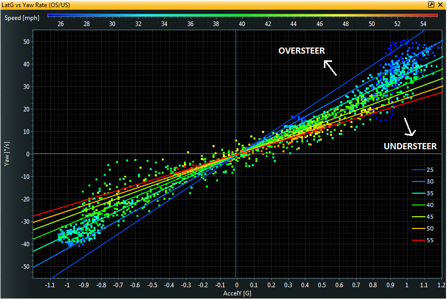

I did something similar to what you mentioned with the math by creating an overlay of the expected yaw vs lat g lines at various speeds. Its interesting to look at but I think the steering wheel angle or steered angle would help a lot more. This graph was from an autocross and I felt that the car was mostly balanced but I am still learning how to drive faster. The graph didn't really show me anything new. Good luck, I am curious what you will come up with!
WGAX-May2015 LatvsYaw - Mod.png (116.5 KiB) Viewed 11773 times

I'm not at all sure that yaw rate will tell you if you're understeering or oversteering. My experience is that if I caclulate lateral acceleration from speed and yaw rate, it closely tracks the measured lateral acceleration. If you want to know the yaw angle relative to the direction of travel, you need to compare GPS direction with magnetometer direction. Unfortunately, neither of those channels are available. You can calculate GPS direction from the fix data in post processing, but you still don't know the vehicle orientation. At high slip angles, you can have significant yaw and still be understeering.
Comparing steering angle to speed and yaw rate would be a better approach.
Steering angle is a relatively easy sensor to add, so that would be a quick indicator. But yes, oversteer cannot be reliably determined from Yaw alone.
