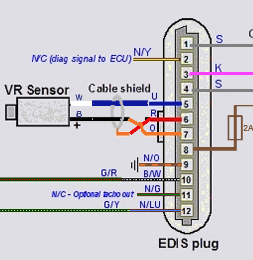

Can anyone explain why we've had to cross over the wires between the VR sensor shield and the VR+ output in order to get a spark from the EDIS? (the VR- is unaffected, still goes to pin 5)
Spitfire MKIV with Fiat 132 DOHC engine/box, not much room for a trigger wheel!
