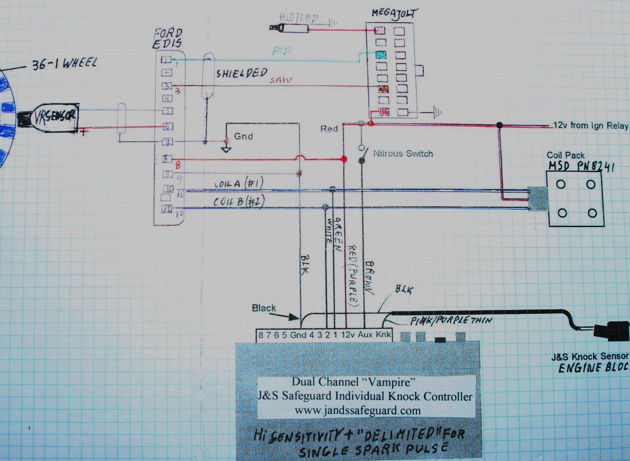

My Plan: I decided to get rid of the antiquated distributor and to hook up the Megajolt, EDIS ignition and S&J Safeguard dual channel "Vampire" anti-knock controller into one congruous system. Here is a schematic diagram tying everything together.

Here is the schematics

Question to everybody:
Do coil wires A and B need to be shielded, too ???
Mr. D
Extreme Esprit Turbo X330,
http://www.thelotusforums.com/forums/garage/
Fantastic!
The coil driver wires don't need to be shielded, but the sensor wires should.
