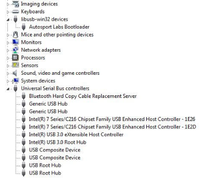

Sorry it has taken so long to respond, I have been super busy lately. It does not seem to reconginze the device when it is plugged in. Here is a screenshot of my device manager with the unit plugged in.
As mentioned, I think the bootloader driver installed correctly, but the regular driver does not.

Hi kcolbey, can you see what is listed under COM devices in Device Manager? RCP should be listed there. Thanks!

I see in your screenshot above that the Autosport Labs bootloader is showing up. Question: is this happening when you simply plug in RCP or are you enabling bootloader mode to see this, by pressing the button?
If it's showing up like that without pressing the button, then it's stuck in bootloader mode.
Try performing the firmware update process with 2.8.7 and see if that gets it further.
If not, what does device manager show when RCP is simply plugged in?
It shows the bootloader driver when RCP is plugged in, and only the two lights are on. Maybe it is stuck in bootloader mode?

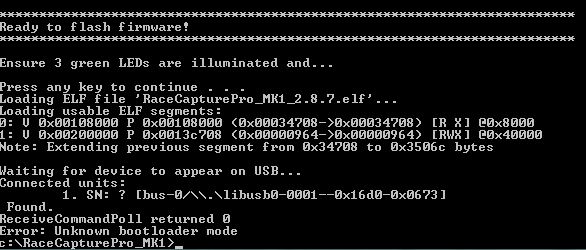

I did some more thinking and playing around to see if I could make something happen. I tried to delete the driver for the bootloader and plug the device back in. When I do that, it goes directly to the bootloader driver. So it does seem that it is stuck in that mode.
However, it still will not flash the drivers. I thought that maybe if I went through the dos prompt to flash the driver the window would not disappear. That suspicion is correct, so now I have a screenshot of what it says!
I attempted to use the correct steps to get the device into the bootloader mode again with it in DOS, but still no luck.
