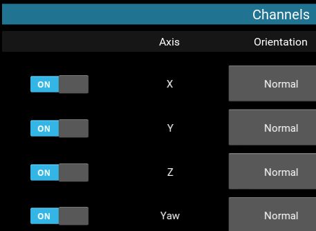

What's the naming convention for the IMU channels? What does 0, 1, 2 correspond to?
https://wiki.autosportlabs.com/RaceCapt ... _Functions
Is it in order of raw value configuration?
0 = X
1 = Y
2= Z
Thanks for pointing this out; we fixed the docs: https://wiki.autosportlabs.com/RaceCapt ... channel.29
X = 0
Y = 1
Z = 2
Yaw = 3
Pitch = 4
Roll = 5
