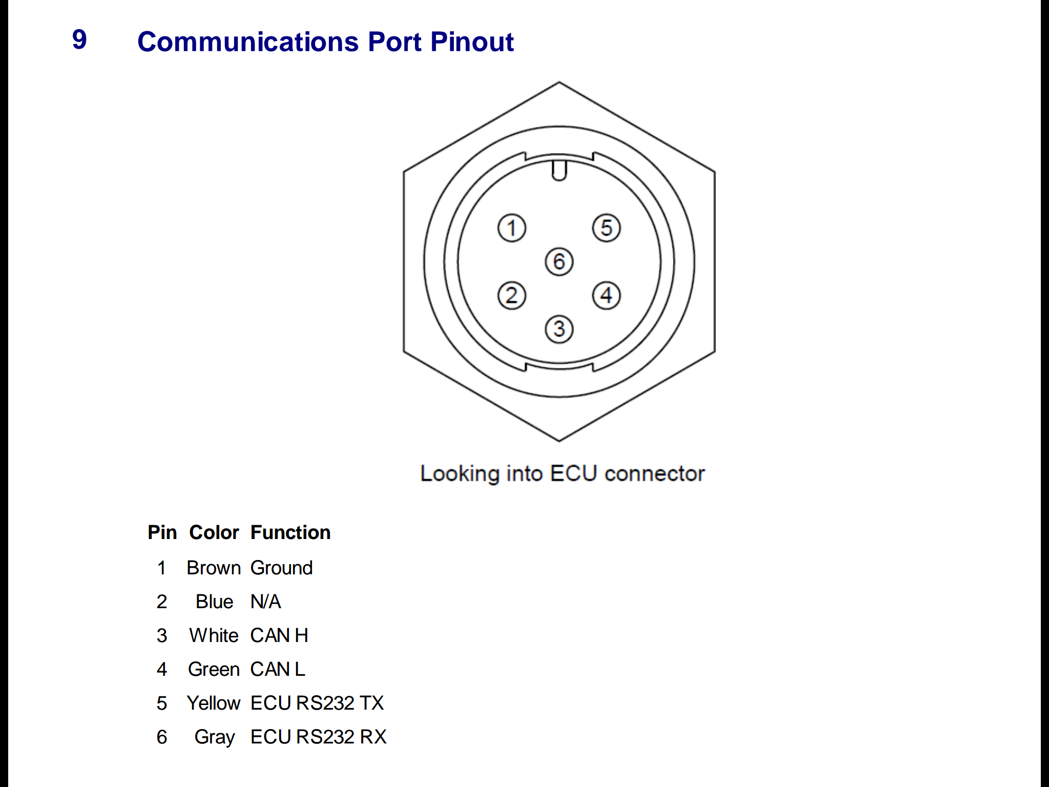

So I got this pinout and I know which pins are CAN
I can get a connector that attaches to the ecu and has flying leads. Would I be best off using that and wiring it into an RJ45 pigtail with corresponding flying leads?

Great! Yes, I would use that cable and splice it with a standard RJ45 ethernet cable as we suggest in our wiki.
