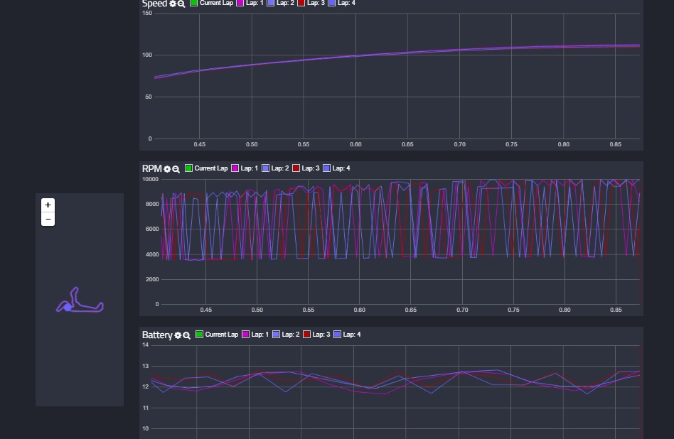

The battery voltage data from my RCPmk2 looks a little odd.
I have a coil-x hooked up for RPMs, a GM style temp sensor (with pullup resistor) and a air/fuel mixture sensor (that has a 5v feed off the gauge).
The battery voltage oscillates a half volt (or more) and the RPM readings seem to oscillate a lot more than they should also.
However, the water temp readings are nice and steady, as is the GPS speed...
Is that somewhat normal, or an indication I have a wiring/ground problem?

RPM fluctuations might be due to a noisy RPM signal; how do you have it connected? How much does it vary?
Battery voltage as well, depending on the load on the car's electrical system. 1/2 volt is not uncommon.

Attached is a screen shot from podium of several laps (zoomed onto the straight)...
I have a 2-cycle (Rotax 593) engine and RPMs are critical. The Coil-X has been modified with a bigger resistor and attached to the wire that goes from the engine stator/magneto to the MPEM (computer controller).
I was not able to get the coil-x to work attaching wires to the coil input and it burned out the standard resistor on the coil-x.
podium graphs of straight
Those are large RPM fluctuations!
What type of ignition system is on the motor - is it a capacitive discharge system, or more like a conventional coil?
