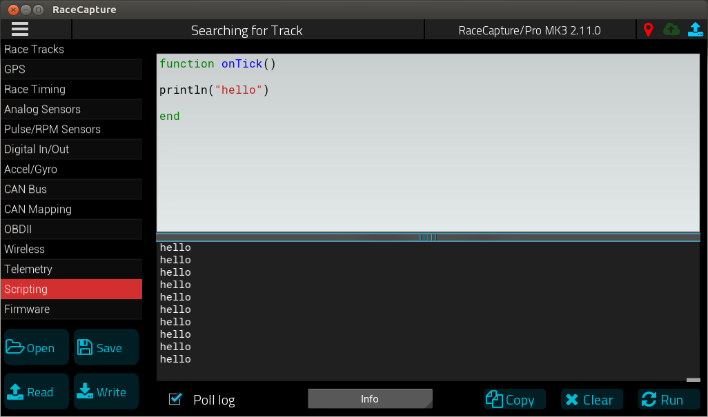

I looked at your script - no where in your script you have any println statements - that's why you're not seeing any messages in the log window below.
An example of seeing a println working is by temporarily replacing your entire script with this simple one:
function onTick()
println("hello")
end
Once you press the "poll log" box then you will see the output in the window.
Screenshot from 2017-06-07 07-47-12.png (67.93 KiB) Viewed 6311 times
