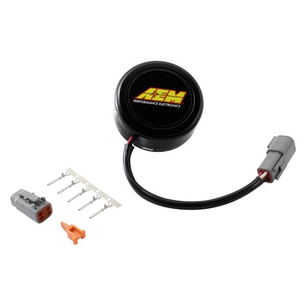

Can the AEM Engine Position Module be used to capture signal as an alternative to a trigger wheel with Megajolt?
See here: http://www.jegs.com/p/AEM/AEM-Engine-Po ... 5/10002/-1
It uses a 24 to 1 tooth pattern, and has both hall effect cam signal and hall effect crank signal output.
I know that this cannot drive drive ignition coils directly.
Hi, Unfortunately this will not work with the Megajolt system. It must use the VR sensor for the Ford EDIS module.
