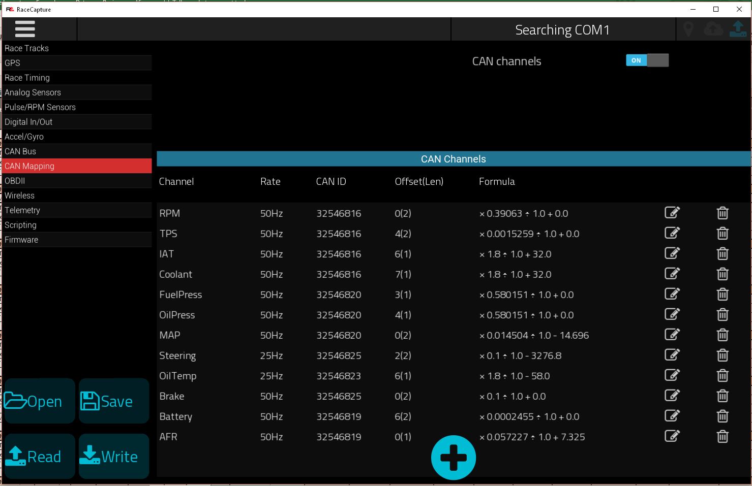

Yeah now that I know the CANID + Info in the AEM PDF it makes it super easy to add all the channels via the CAN Mapping tab. The script that you guys made before just helped me associate the can ID with the table in the PDF because it gave me known good values to start. I am going to update firmware to reset the box, then I will apply all the CAN channels via the mapping GUI.
Thanks for the help!

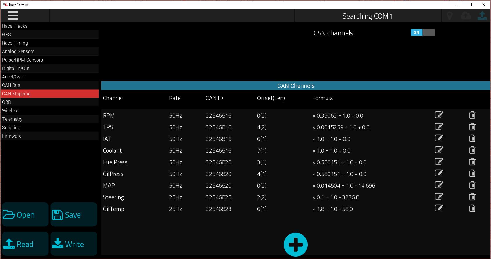

I'm stumped.
I have gone through all the AEM PDF, used a hex decimal converter to confirm the CAN ID is correct.
Using the offset and lengths that are used in the script and known to work. I have gone through and assigned big and litte Edian based on PDF, and signed/unsigned. But I am getting nothing on any of these channels.
an thoughts would be appreciated!

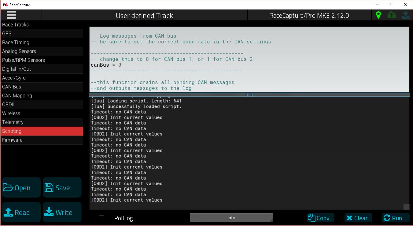

What I would recommend doing is to first turn off your CAN channels and then try (re-try?) the CAN bus logger here to verify the CAN baud rate and CAN bus you're connected to.
https://wiki.autosportlabs.com/CAN_Bus_logger
Make sure you replace any existing script with the logger script.
Do you see the AEM data pouring into the log window?

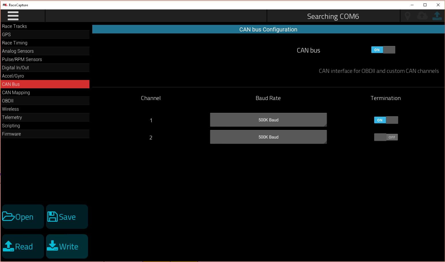

Is there a way to hard reset all setting and scripts to make sure that there is no possible interference?
I have confirmed that the CAN is enabled and the Baud rate is selected and 500k, does termination need to be turned on? I have it on.
- Capture.JPG (91.31 KiB) Viewed 69879 times
ran the script and got the output pictured:
also turned the CAN on and off and got this:
