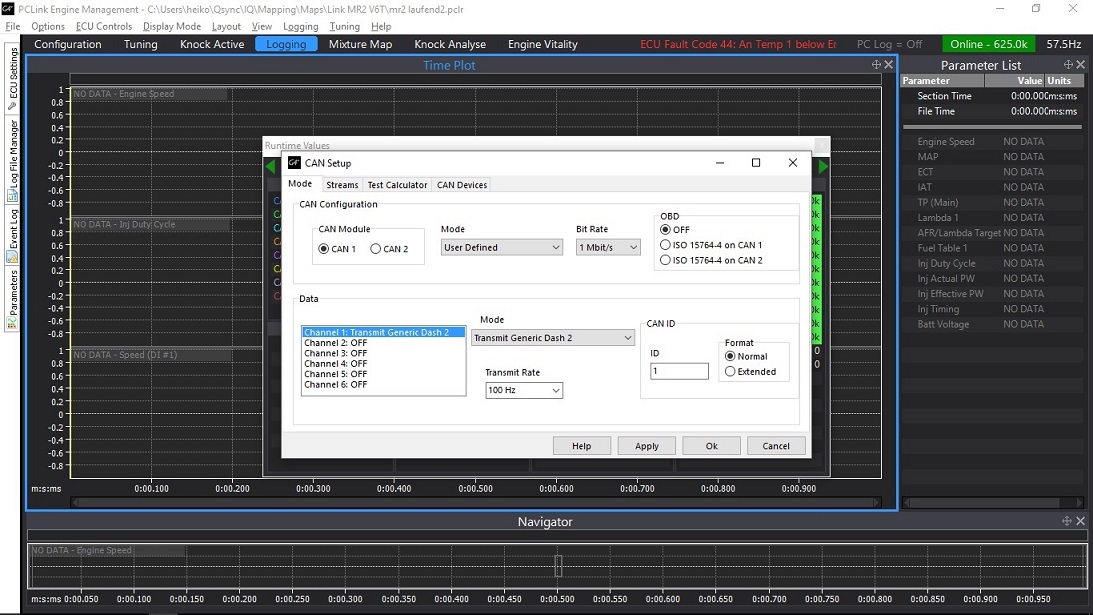

I got problems with connecting the racecapture to the link g4+. I set it up as the verified guide for the link g4 ecu. I think there are some settings missing, which you need to do on the side of the link ecu. The bus itself seems to work fine, as i am getting no errors on the used Can 1 to where the RC is connected.
Regards Heiko

Heiko,
I think you need to define a CAN ID which matches the RaceCapture CAN script... LINK use CAN ID 1000 as their base ID very often (at least it's mentioned in their help file). From the screenshot it looks as if you have defined CAN ID 1 in your config...
The RaceCapture example script you mentioned above has CAN ID 1200 (decimal) set as the base ID. So you may either choose CAN ID 1200 in your LINK CAN configuration page or change the RaceCapture script to match the CAN ID you prefer to use with both LINK and RaceCapture.
As a side note I observed that the RaceCapture example script doesn't has MGP (boost pressure) defined but LINK is transmitting this data too as well as a few more... you may like to add these parameters within the script or even choose a custom CAN message and output whatever else data to be received by the RaceCapture device.
In case you need additional support I would probably be able to guide you through the setup using german language communication as I'm a RaceCapture dealer in the german speaking region of Europe...
Please come back with your findings!
Good luck!
Mike

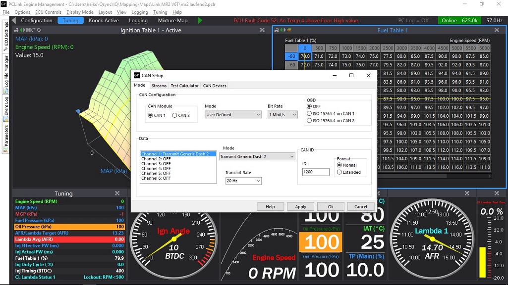

Thanks a lot @MikeD! You gave me the missing input!
Attached you´ll find the correct Link ecu can settings.
I also corrected the the lua scripting:

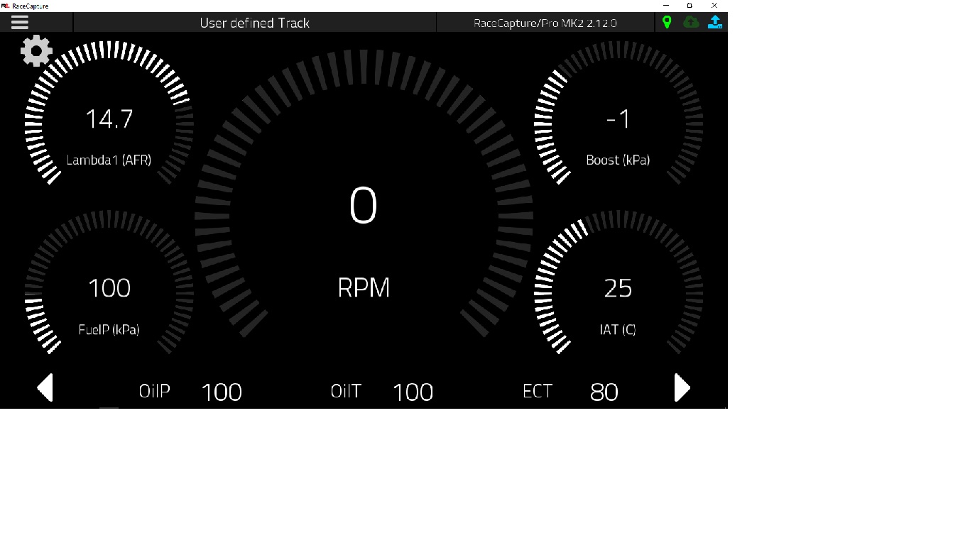

This link has been HUGELY helpful for us setting up an E36 with the Link G4+ and a RCPro mk3.
We made a custom cable, and with the Link and Lua settings above, have been able to get them to talk to each other.
However, when looking at our dash or raw data, the CAN bus data is showing for an instant, but then is replaced by 0's. It continues to flash data/0's. Brent, can you suggest ways to get the 0's removed from the stream? Do I increase the tick rate to something higher than 30ms?
Other analog and digital inputs are working great.

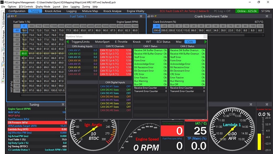

The answer to your question is you probably have a channel defined elsewhere in the system with the same name, and the two channels are stepping on each other.

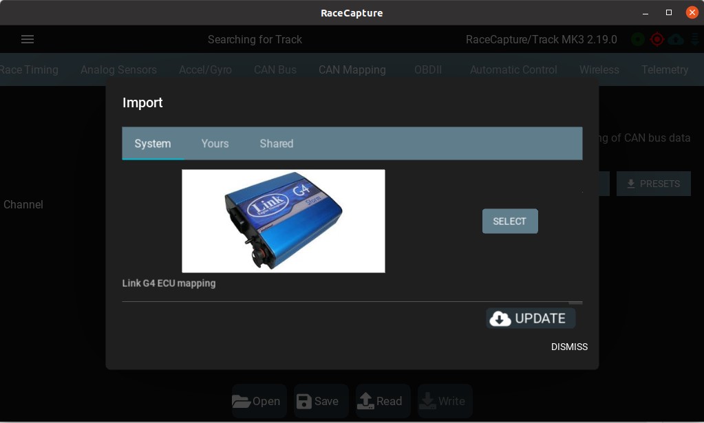

Re: Link G4+
However, you should be using the Link direct CAN preset we have in the system, instead of the Lua script - it works much better and has faster response.
https://wiki.autosportlabs.com/CAN_Bus_Integration
Note that this post was from 2017, before we had the direct CAN integration available.

Re: Link G4+
Hi Keith,
The presets are just a convenient way to load channels into the CAN mapping feature; each individual channel is otherwise fully editable. The mapping system is documented here: https://wiki.autosportlabs.com/CAN_Bus_Integration
In addition to system presets, you can also save your own custom presets.
With their CAN protocol in one hand, and our current mapping in the other hand, you might be able to just adjust the CAN IDs, if the channels are otherwise configured the same.
Feel free to link their documentation here and we can take a look. Thanks!
