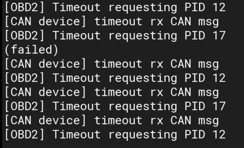

While it's trying to get data from OBDII, try getting the RaceCapture log here, it might have some useful information:
https://wiki.autosportlabs.com/RaceCapt ... apture_Log

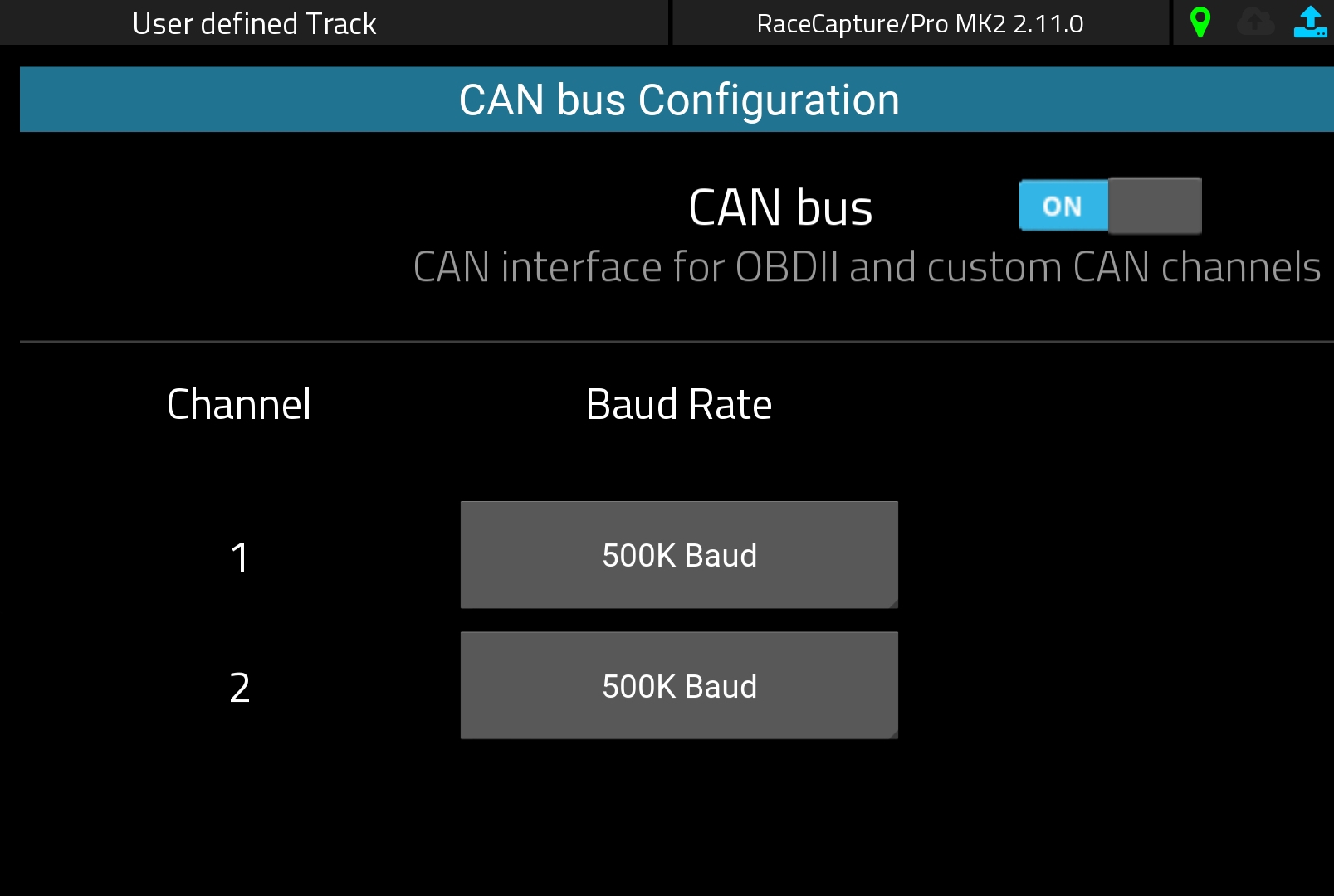

Finally, you can double check your setup to ensure your OBDII is configured correctly. Also make sure CAN bus is set to 500K baud and verify other settings according to the guide here:
https://wiki.autosportlabs.com/OBD2CAN

I'm setup that way with my OBDII configuration.

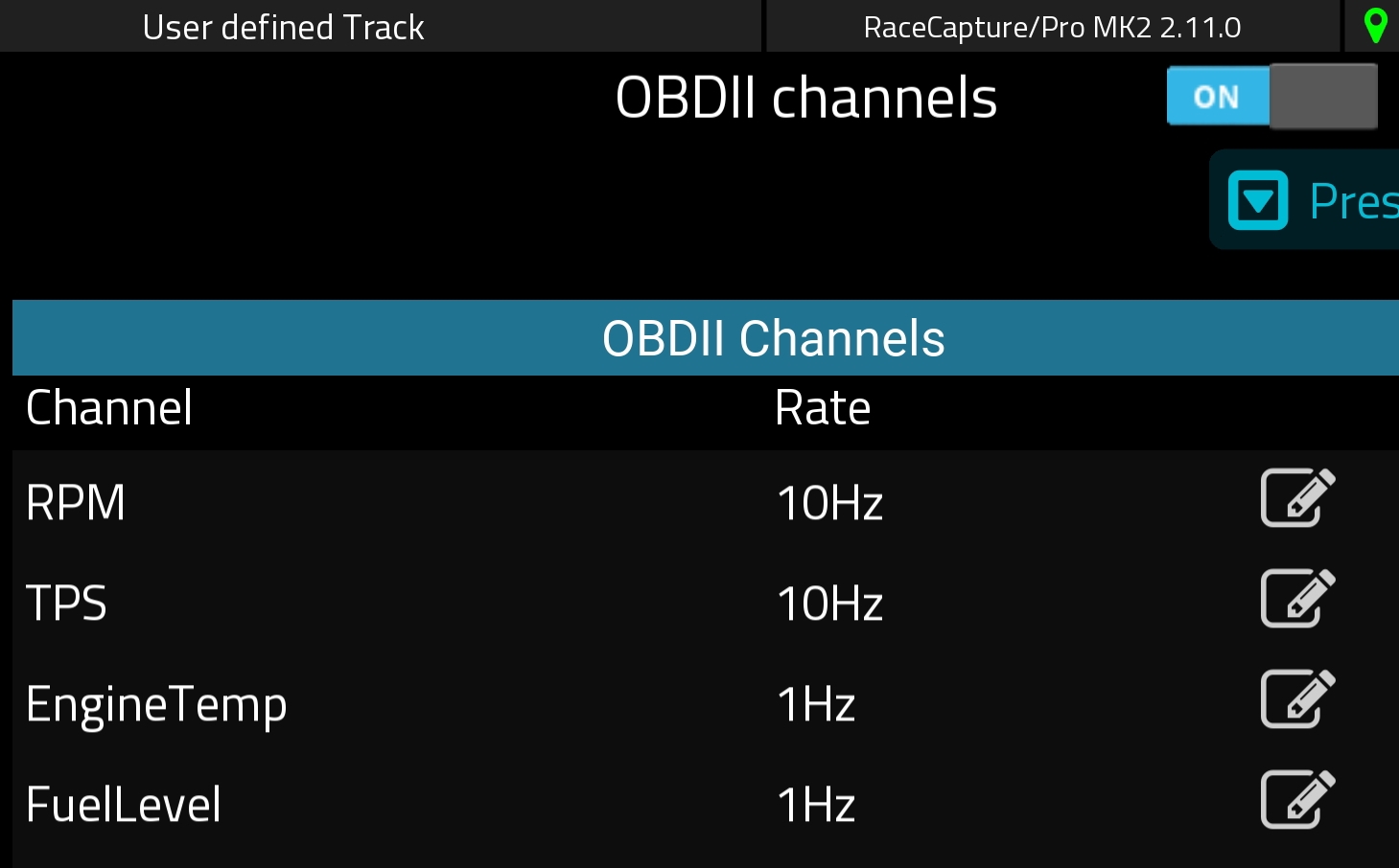

The cold winter is finally over, so I was able to get to the car... Here are some screen shots of what you requested.
Thanks.
