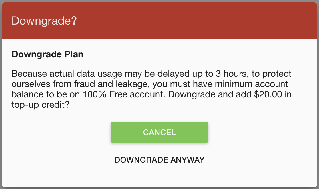

brentp wrote:Also, when you register, be sure to downgrade to 'basic $0' (if that's what you want) - clicking through the warning messages. Your total monthly bill should be $0/month under their invoices page.
It looks like they want you to cough up $20 to do this now.
Screen Shot 2019-11-08 at 8.29.34 PM.png (84.48 KiB) Viewed 59765 times
That's right. They described it to me, and it makes sense, although complicated. There is a condition where a data overage could happen, and due to their relationship with AT&T as the MVNO, they could not catch it fast enough to bill for that overage. So they need a buffer in the customer's account to catch that.
Without this buffer, they were losing money in an unacceptable rate.
Still, having the $20 account buffer in there and then $0/month thereafter still seems like a good deal.
