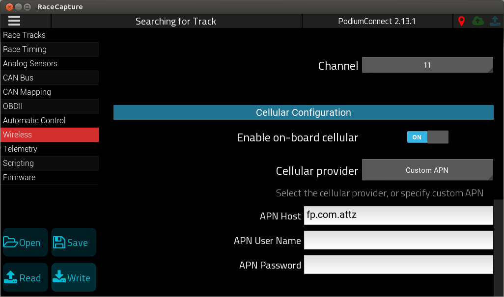

Thanks for posting- let's get this sorted out.
First, you'll want to make sure the cellular setting is turned 'on' under wireless, and then ensure the freedom pop APN settings are set correctly. We have it in this blog post: https://www.autosportlabs.com/freedompo ... telemetry/
Set the APN name to: fp.com.attz
User and password should be left blank.
You also need to add your Podium Device ID under telemetry settings, provided by your account at http://podium.live.
Once you set all of these options, write the settings back to RaceCapture/Pro, then give the box a power cycle.
Make sure the cellular antenna is connected, and watch for when the telemetry LED starts flashing, and also watch for an event to pop up under http://podium.live/home.
We also have a step-by-step guide that covers the above, here: https://wiki.autosportlabs.com/RaceCapt ... _telemetry

- FP_cellular_settings.png (61.3 KiB) Viewed 18892 times
