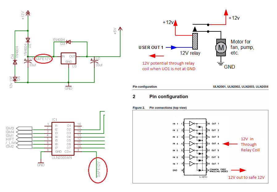

I'm running an experiment on my desk with my spare V3 unit. Currently I have only 2 wires to it connected to Gnd and User Out 1.
User Out 1 is connected to pin 85 of a standard automotive relay. Pin 86 is connected to 12V as per the diagram listed above. The coil has a resistance of circa 75 ohms. The megajolt is alive and talking quite nicely with my pc.
Can the ULN2003 somehow shunt the 12V back down its Vcc pin thus powering the unit?
To recap, the ONLY connections to the Molex are Gnd and User Out 1.

I've been looking at the data sheet for the ULN2003. The internal freewheeling diodes will allow 12V through from the outputs to the 'safe 12V' line of the mjlj which I think is powering it up.
My next trial will be to remove pin 9 from the circuit and add the freewheeling diode at the relay instead and see what happens.

Here's what I have found.
There is a slight error when using a relay off any of the user outputs if that relay has a permanent feed as it will power up the MJLJ unit.
This is due to the way the 12V line from Pin9 of the ULN2003A is connected to the input of the Voltage regulator IC.
See attached diagram.
The simple solution is to have the relay switched off with the ignition.
This however, is not ideal when running an electric fan as, like I have done, it has an override switch to allow it to be run independently of the ignition / MJLJ.
In this situation the solution is to disconnect pin 9 of the ULN2003A and fit a freewheeling diode across the relay terminals instead, which offers the same protection and is quite common in automotive installations like the old relay type immobilisers from the 90's Moss alarms etc.
- Relay Issue.png (59.51 KiB) Viewed 26459 times
