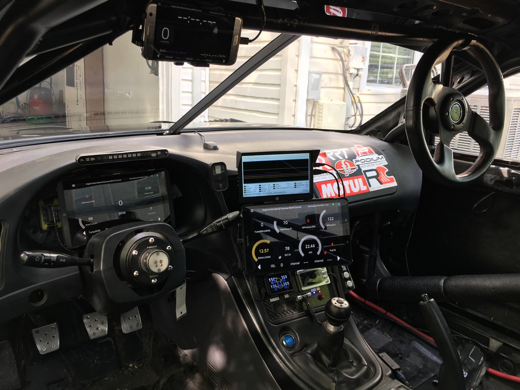

So far everything for the most part is working well.
There is one issue I'm having with my Samsung Galaxy Tab A 10.1. Tasker for some reason sometimes doesn't take airplane mode off, while it does all the rest of the actions like turning on the screen and switching to the RC App. So the app comes on, but it can't connect. It's happening for me like 10% of the time. I might just need to double up the action or something. This issue never happens on the Nvidia Shield K1.
As I figure things out I've been updating that document so if I do solve this I'll make sure to update it, but I should I guess note things here too for reference for people that have already gone through the docs before.
I ran my new setup with my K1 and 10.1 dash this weekend at VIR and it worked very well, and impressed a lot of people attending Hyperfest. I never touched the tablets, they just automagically worked when I turned on the car.
