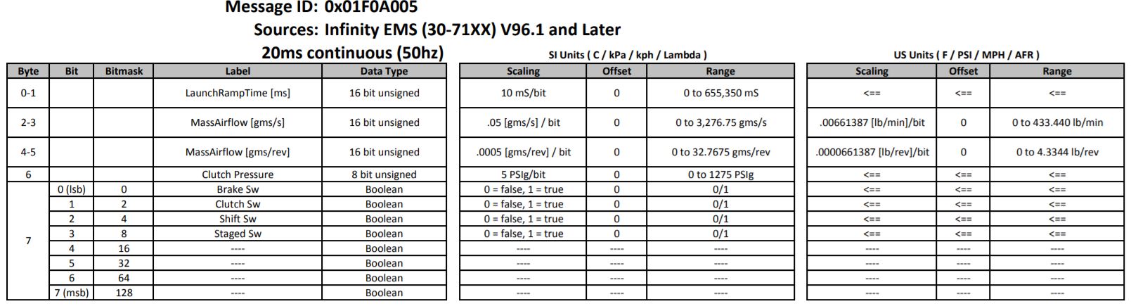

Hi all,
I'm trying to decode Can byte 7 where every bit represents a digital state. Could you please help me with this. Believe its bit mode but I can't get a handle on it.[/img]
MikeD
Posts: 39
Joined: Sun May 29, 2016 11:55 am
Location: Austria
Post by MikeD »
Hi fitdes,
try bitmode with the following settings:
BrakeSW offset 63, length 1
ClutchSW offset 62, length 1
ShiftSW offset 61, length 1
StagedSW offset 60, length 1
