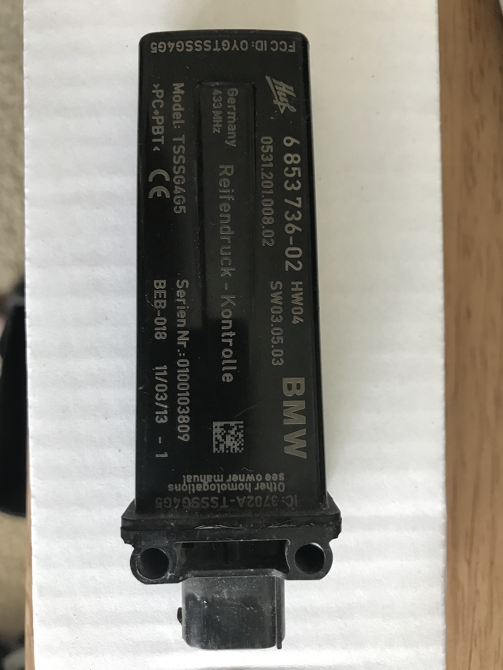

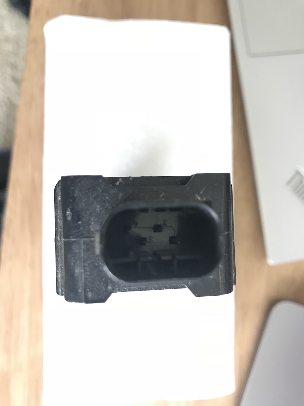

Here's a picture of the module itself. It has ground, power, CANH, and CANL connections and typically mounts under the car somewhere below the spare tire well. I think it's commonly used on BMWs and other makes, though each manufacturer may have their own CAN implementation.
From some digging, looks like it requires a "wake up" command via the CAN bus. Will update when I get it powered on and start tracing the messages. Might need to find someone with a F30 BMW willing to let me tap into the CAN bus....

Interesting. I noticed the same thing with a Fiat unit I tested; it never broadcasted any CAN data.
Looking forward to seeing what you might find out!
