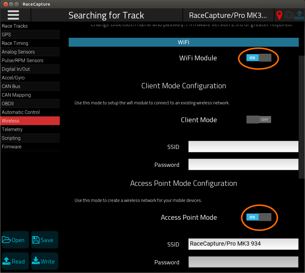

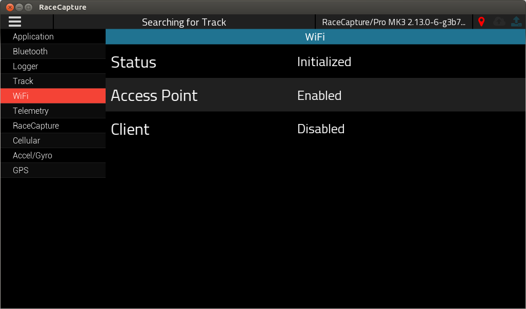

Hi Tim,
The WiFi connection is only for Android and iOS; on desktop only USB is supported. With Bluetooth, only one connection can exist at the same time. With WiFi, you can have two connections at the same time.
Since you flashed firmware, can you report exactly the name of the firmware shown in the upper right corner after you're connected (e.g. USB)? Does it say "RaceCapture/Pro MK3 2.13.5"
For WiFi, the first step is to confirm you have both WiFi and Access Point mode turned on in the WiFi settings. You can leave client mode turned off for now.
Make the settings look like the attached image, then "write", and do a power cycle.
Then, after you re-connect, read the configuration back to verify the WiFi settings are persisted.
Finally, go to Status / WiFi section. (via hamburger menu in upper left).
Check that WiFi Shows "Initialized", per the screen shot attached here.
Thank you for your patience, we'll watch for a reply here.
