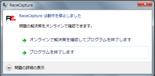

Hello,
i installed RaceCapture APP 1.13.1 to Win7.
if i click the "Analysis", stopped working and program done.
Could you solve this issue ,please?
Japanese language
Japanese language
Hello,
This is a known issue with Windows 7 and certain video drivers.
The solution is to use a different computer, or upgrade your computer to the latest supported version of windows (Windows 10).
Thank you, and sorry for the inconvenience.
