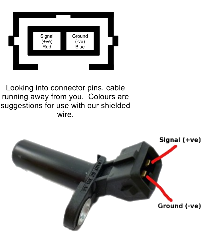

the only different thing i did was i pulled the wire on vr sensor and re-wired it. :files/cranksensordiagramannotated_large_912.png
the wiring is 100% correct from sensor as per link, i checked for continuity also and there is no cut in the wire from sensor to edis.

also checked resistance on vr sensor.
put multimeter on 2000ohms setting and got a reading of 391.
but when i let the positive lead on pin 6 and negative lead on pin 5 to measure the voltage , i get 0 V when I am cranking.
