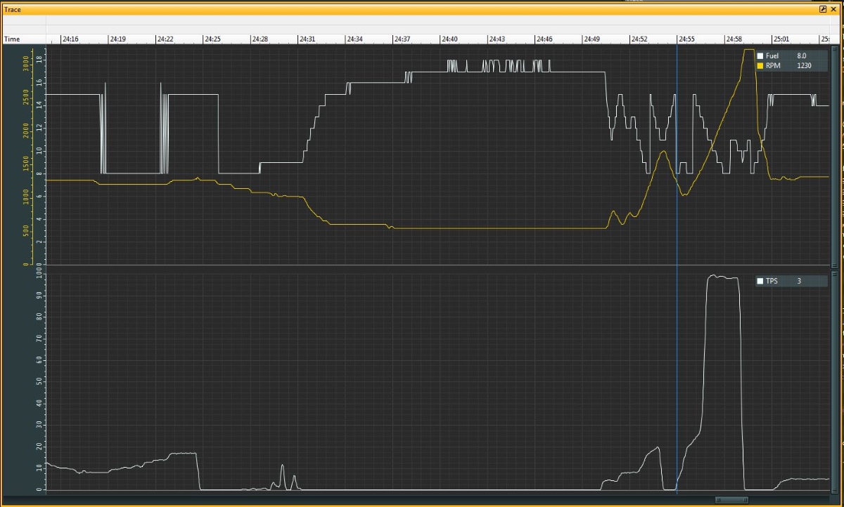

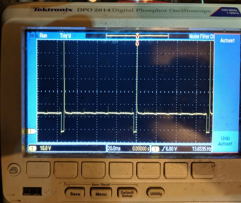

I've been wanting to measure my fuel injector pulsewidth for quite some time for use in fuel consumption calculations and for backing out a fuel map for the day when I convert this engine to a megasquirt. I tapped a wire of the number 1 injector and hooked it up to a pulse input. Then I set the channel as a pulsewidth measurement, medium timer speed, logged at 20hz. It appears that the signal is sort of inverted as when I'm at idle the pulse width "fuel" channel on my log is higher than when at higher speed/load. The reported signal also appears to be a bit slow to change, I need to go run again with the time speed changed, but I'm still not sure this will fix my issue. I checked the pulsewidth on my oscilloscope and it looks to be just under 4 msec at idle, sadly I forgot to actually measure the pulsewidth with the scope.
Anything else I should be trying / looking at to get this logged correctly? I checked the forums but hadn't seen where anyone else had measured pulsewidth yet on the racecapture. It's and RC Apex by the way. Pics to come in subsequent post.

The signal to a fuel injector is typically a low-going pulse -- as the other side of the injector is connected to permanent power. If the measurement is of the high pulse (injector closed), then you need to so some math with the engine cycle time to determine the fuel pulse width. This is assuming sequential fuel injection, where there is one fuel pulse per cycle.

What you said matches what's going on in my data, it's picking up the other part of the pulse which explains the inverted nature of this.

OK, looks like the pulse width timer is overflowing as well (the jaggies that increase while you are increasing the RPM). Perhaps Brent will tell us if there is a way to directly measure the low-going pulse width.
