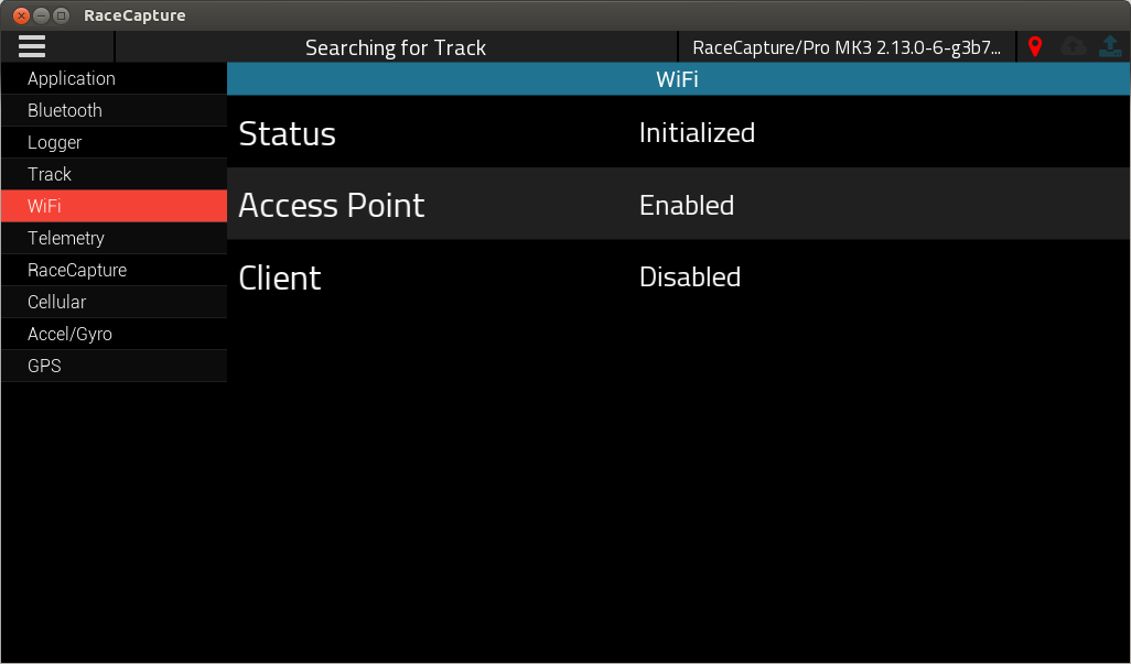

For the WiFi client connection to the GoPro, check that the client shows "Connected" under System Status/WiFi. This will mean that it is connected to the GoPro's WiFi connection. (The screen shot attached shows the screen, but with the client "Disconnected")

I'm not finding that page. Where do I find it? I think you have a different version of RaceCapture. Your photo shows 2.13.0-6. I show I have 2.13.5. is that page available somewhere else in my version? I think I've seen it, but it might have been before I did one of the updates.
In the app, press the hamburger menu in the upper left. Then, select "System Status".

I was able to find the page easily enough, and now the system is working as it should. The only change I made was (since I had the data logger out of the car) rather than use RPM to trigger it, I used pitch to trigger it. Since RPM was previously triggering the data logger, I wouldn't think that change would make it start communicating properly with the GoPro. Oh well. At least it's working now, and I know how to check the RaceCapture page to make sure the GoPro is talking to it before I take the track, so I'll know whether I need to manually start the GoPro or not.
