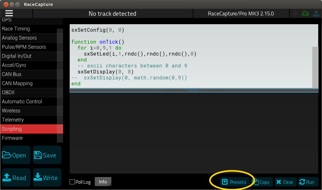

Hi, yes, it is a new feature in the latest app. Go to the script window, press "Presets" and you will see a list of script presets.
Be sure to press the cloud update button to get the latest.
The one loaded right now is the demo script which will work with your ShiftX2 (requires 2.15.0 firmware or higher).
