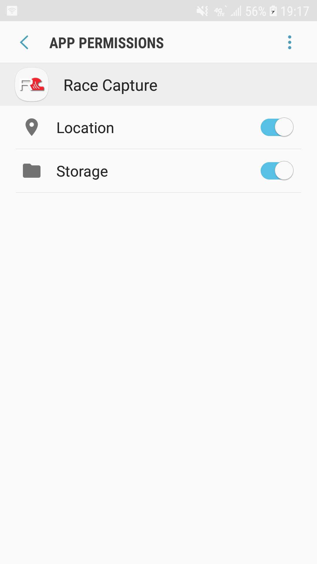

I verified the RC app permissions and storage is permitted.
I tried several different folders.
No go. Same error.
WTH? This surely has changed since I didn't have that issue before the latest couple of app updates.
What next? Wipe and re-install app? I'll surely loose the data files.
2002 Boxster S
there was a change we were forced to make due to Google's changing API requirements, and this required handling how permissions are requested for apps. However, with permissions enabled you should still be able to save to the file system.
One thing you can do is install an Android file manager, and create a new folder under a location on the device, like the DCIM folder.
e.g.
DCIM/test
Once you create that folder, try finding that folder using the RaceCapture app and exporting your file to that folder you created.
Let us know if that works.
