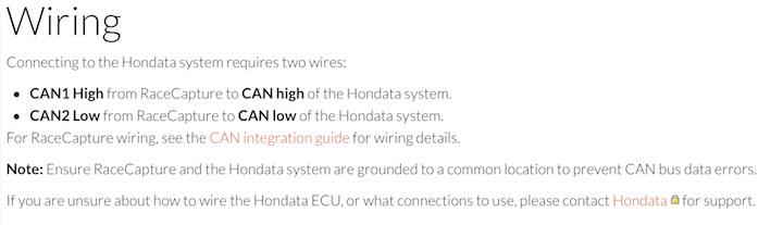

Not sure if this is the best place to post this, but I was working on integrating our Hondata S300 CAN data into our RCP MK2. Long story short, the instructions for the Hondata integration show that the Connection for the RCP should be to CAN1 High and CAN2 Low.
I could not get this configuration to work, so I changed to CAN1 High and CAN1 Low. Everything seems to be working now. Simple fix, but I spent quite a bit of time searching for other reasons why I was not getting data.
Would it be possible to update the Wiki for the Hondata to others in the future?

Isn't the whole idea of a wiki that the users can update the pages to fix the typo's and such. BTW, the page with the bad info is:
https://wiki.autosportlabs.com/Hondata_KPro4

Fixed!
Thanks for pointing that out. We locked user registration for the wiki, otherwise it would be run-over by bots with their spam updates.
