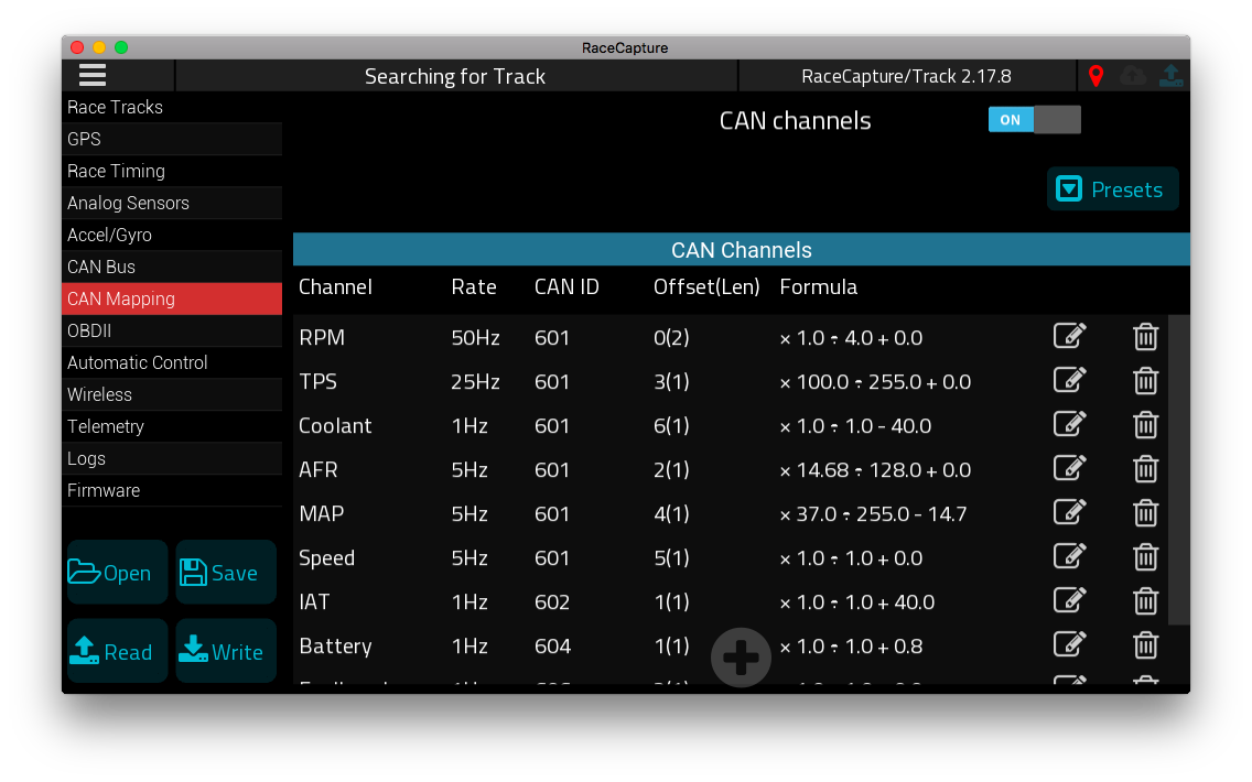

My RCTrack only allows me 10 mappings before the UI disables the add button. Is 10 the limit?
Is the limit higher on the Pro unit?
Screen Shot 2020-08-05 at 12.53.22 PM.png (121.21 KiB) Viewed 13219 times
Hi Mat, I think we already mentioned it separately, but for the good of the group, RaceCapture/Track MK1 only supports 10 channels.
