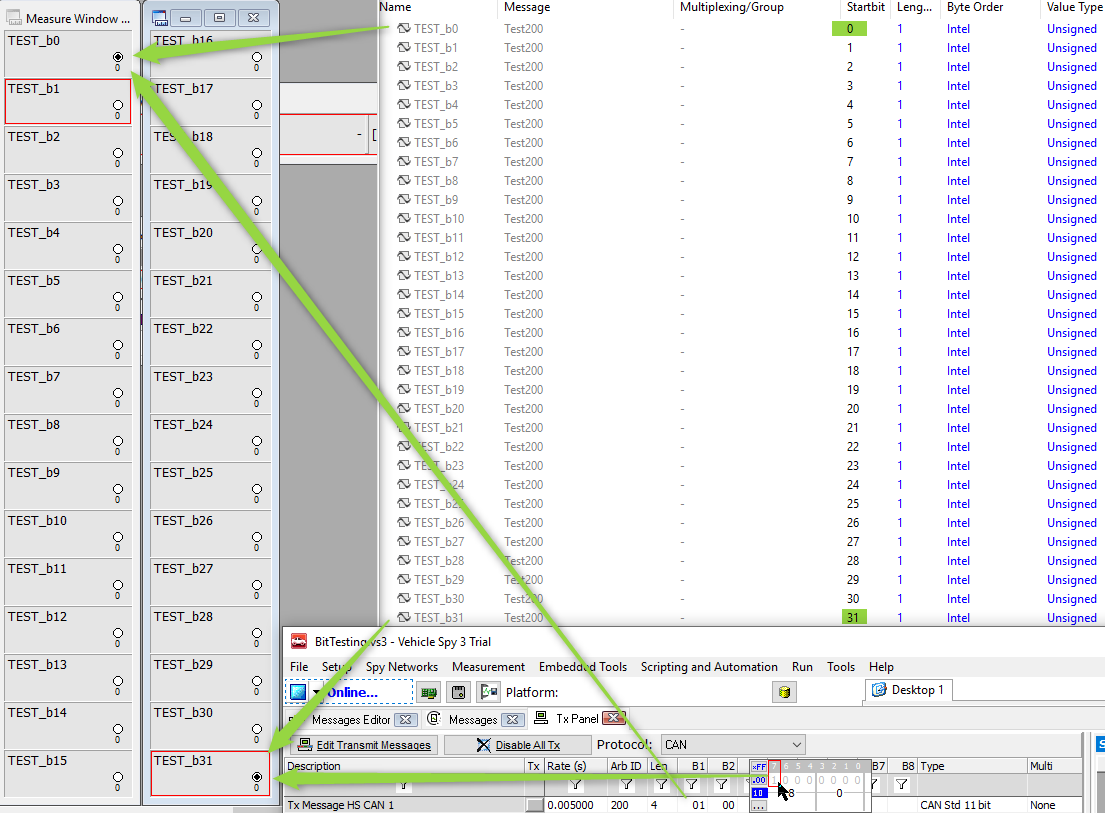

To prove this I added a message to a CAN DB, made individual signal names TEST_b0 for Startbit 0 and so on.
Configured RaceCapture the same way, TEST_b0 had offset 0, and so on.
Used an external device to send the CAN message. (Ignore the "improper" naming convention where B1 is really Byte 0.)
Sent 0x01h on B1 (Byte 0 / bit 0) and you can see that TEST_b0 is illuminated.

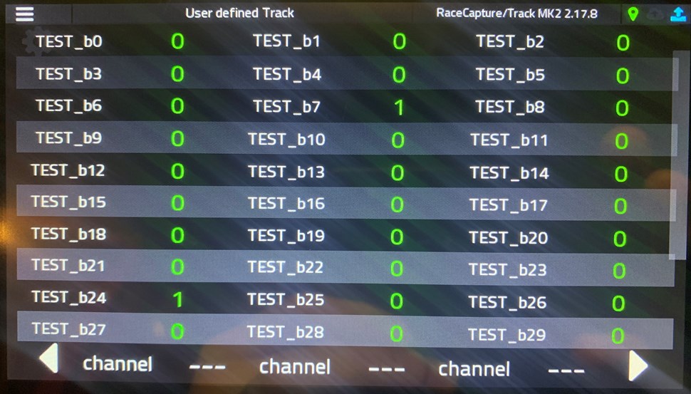

Sent 0x80h on B3 (Byte 3 / bit 31) and you can see that TEST_b31 is illuminated.
What showed up in RaceCapture was exactly wrong.
See that TEST_b7 was set instead of TEST_b0, and TEST_b24 was set instead of TEST_b31.
