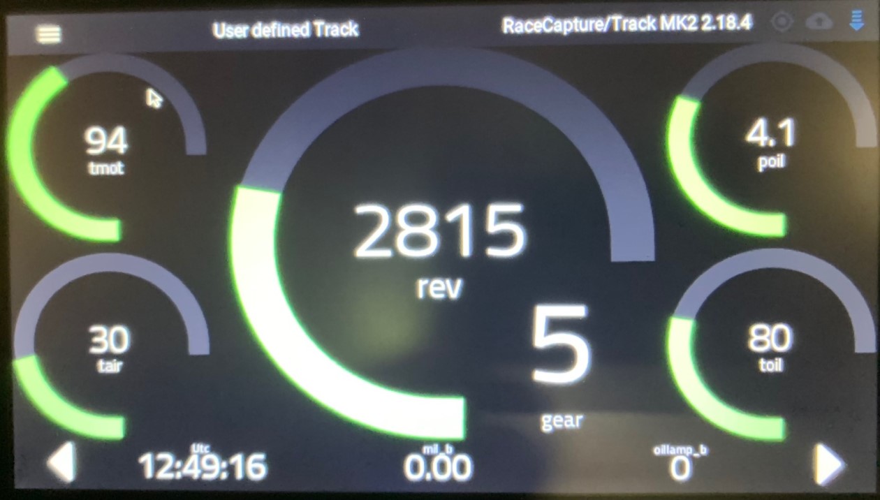

You can see that it froze at 12:49:16.
It's not the RPi App itself, as the touchscreen is still responsive and I can go into the system menu. It's the RC Track itself which seems to freeze. It's always done this, no matter the version of the RPi App or the version of the RC Track firmware.

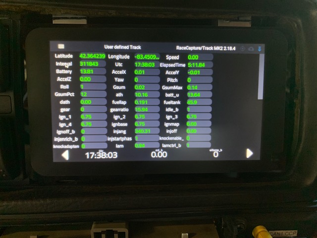

It has nothing to do with a laptop being connected. The dash values froze after idling the car for a few minutes in the garage, not even while driving. Just the RCTrack Mk2 and the RasPi dash. The Raspberry Pi app is fine, it's still responsive. The dash values freeze, as in the RC Track freezes. Screenshot shows it froze at 17:38:03. And yes, when it freezes everything stop updating, not only the CAN values but also the UTC clock.
Doesn't appear to be anything related to the USB connection because if I cycle the power without touching the USB then everything is fine. And it can't be CAN, because then the UTC clock would keep working. That's why I'm suspecting the RC Track itself.
