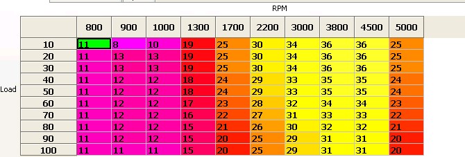

What does everyone think of this as kind of a baseline map for my 68 bus? Its a bone stock dual port with low compression(7.3:1) pistons. Initially the stock dizzy was spec as follows:
Idle advance: 7 deg BTDC
Advance/Retard Range: Vacuum: 2-5deg Adv; Centrifugal: 12-16deg @ 2200rpm, 22-25deg @ 3800rpm
I'm not trying to turn it into a screamer or anything. I just want proper timing for fuel economy(#1) and power(#2) on 87 octane. Plus my current distributor isnt proper for a bus nor advancing right, so this seemed like more fun than simply buying a new one.
David, looks pretty good. Drive it and tweak it, that's what I did. Certain areas on mine had too much advance, so I backed it off, some areas not enough. I am on configuration file 11, just minor small changes to my initial map. I changed the low speed, 1000-2000, and some of my part load areas. I have a 10:1, 2165cc type1 w/dual Weber 44IDF and a killer cam, heads, valvetrain, and exhaust. Engine by Jake Raby, puts out 180 hp and over 140 ft. lbs. Max advance is 32-33 degrees at full load.

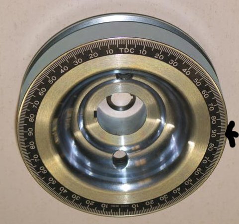

So to make sure I do this right before I go drilling my pulley full of holes....
First off, is the timing wheel on this pulley the proper orientation relative to the notch for the woodruff key in the crank?
Second, I would want to drill my holes on the the x5 degree lines (5, 15, 25, 35, etc) correct?
And then on the right side where the black arrow is, that is where I would want the "missing tooth" to be assuming I can position the sensor right at the TDC mark?
Not that it really matters, but this is the actually pulley that I am using: http://www2.cip1.com/ProductDetails.asp ... 26-105-260

Assuming Type 1 VW ( and I would guess Type 3, but don't own one ) TDC should be 90 degrees clockwise from the woodruff key. I can't tell exactly because the picture is at an angle, however it appears correct.
Yes, the holes should be on the 5 degree lines to make the "teeth" on 10 degree lines.
Yes, assuming you wanted the sensor at TDC, the "missing tooth" should be 90 degrees clockwise from TDC, but if you are using a conventional generator or alternator TDC will not work because of the belt. Take the advice of someone that has messed up and had to machine a new woodruff key slot in one to "move" the "missing tooth". Mount your VR sensor, sensor cable, pulley, and all accessories ( alt, belt, header, full flow lines, etc. ) that are near it to make sure the VR sensor will go where you want it before you machine the "missing tooth".
The first spot I had picked, and built a mount for, while the engine was on the stand would not clear the header once I put the engine in and installed the header. The sensor is now between the belt ( that is, in the space clockwise from TDC between the crank pulley and the alternator pulley where you do not trap the belt with the sensor and bracket). My bracket is mounted to one of the studs that hold the alternator stand on. Need to get off my but and take some pictures to post in the powered by gallery.

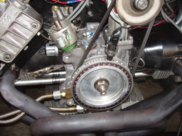

Just thought I would post an installed picture.
Ignore the timing marks, they are off 130 degrees now due to the new keyway I made to relocate the sensor.
