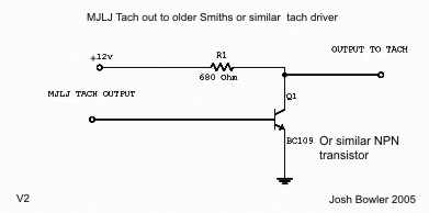

i sorted it, i made a little circuit up and just tested it, i tried a smiths tach and a vdo tach and they both work fine! if anyone is interested i will sort out a circuit diagram, it basicly converts the MjLj RPM output into a signal older tachs can use :-)

hehe, i put the diagram in the files section, I just added a much simpler version also thatstill seems to drive smiths type tachs from the MJLJ output

I'm interested in this., but can't find the files section!! can someone direct me?
dave9469
Posts: 37
Joined: Mon Mar 05, 2007 6:25 pm
Post by dave9469 »
Steve
I think this is the diagram Josh made but I don't know if there have been any updates to it, it says it's version 2.
If you use it let me know because I'm intending using a smiths gauge from a scimitar.
Dave
It's important to note- this circuit was designed to accommodate the MJLJ V2/V3 design; In MJLJ V4 the TACH_OUT circuit was changed to essentially the same circuit as Dave posted.

Is this meant for the RVC voltage-sensing type tachos? ie where the original coil -ve would simply have been connected to the tacho's singal input, rather than the older loop-through style RVI inductive sensing type?
steve_c
Posts: 36
Joined: Wed Dec 13, 2006 2:59 pm
Post by steve_c »
At a guess I would say this was for the RVC type tacho's. Mine's an RVI. The current handling capacity of the BC108 is only 100mA so I would guess that this would burn out if connected to the RVI. I don't know the impedance of the RVI tacho so can't say for certain. I will do some checking over the weekend. I don't particularly want to spend out for another tacho if I can get away with a simple high current switch.
Josh_b mentioned in one of his posts that another member (lotus68racer?) had "run the 12V common lead to the coils from the tach", thereby running the coils primary current through the tacho in a similar manner to how the RVI tacho would have worked in a distributor system. Does anyone have any further info on this mod?
