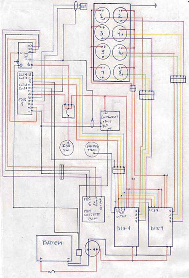

Here is a diagram of the system I built with 2 MSD DIS-4 modules. I am completing a digram with 1 DIS-4 module. In either case the same problem occurs.
