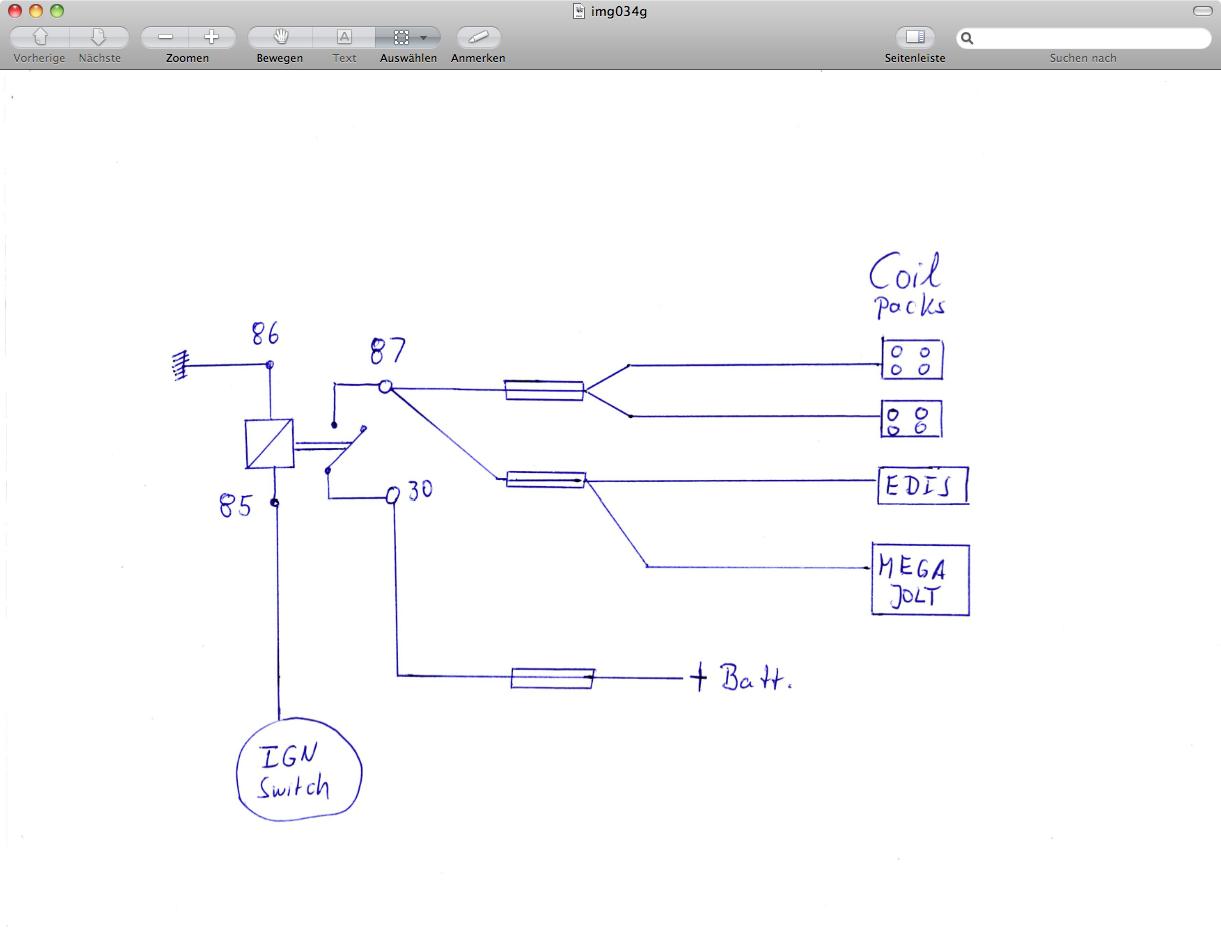

I'm about to put the MegaJolt EDIS into my car.
I have planned to put some fuses and a relay in.
What values of fuses should I use ?
Please have look at my sketch.
Sketch EDIS.png (188.32 KiB) Viewed 21275 times

Why so many fuses? I just used a single 20 amp circuit breaker in the supply wire from the battery for the whole system.

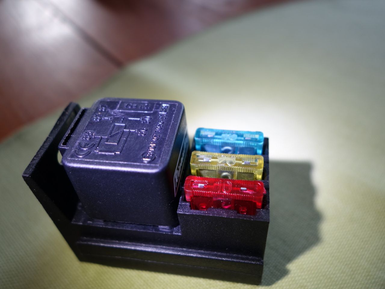

One reason is, I have this nice little holder for the relay.
The other reason is, I can distribute easily the power from one point
to the four devices. Two coil packs, EDIS module, and MegaJoltBox.
How do you connect four wires to one wire ?

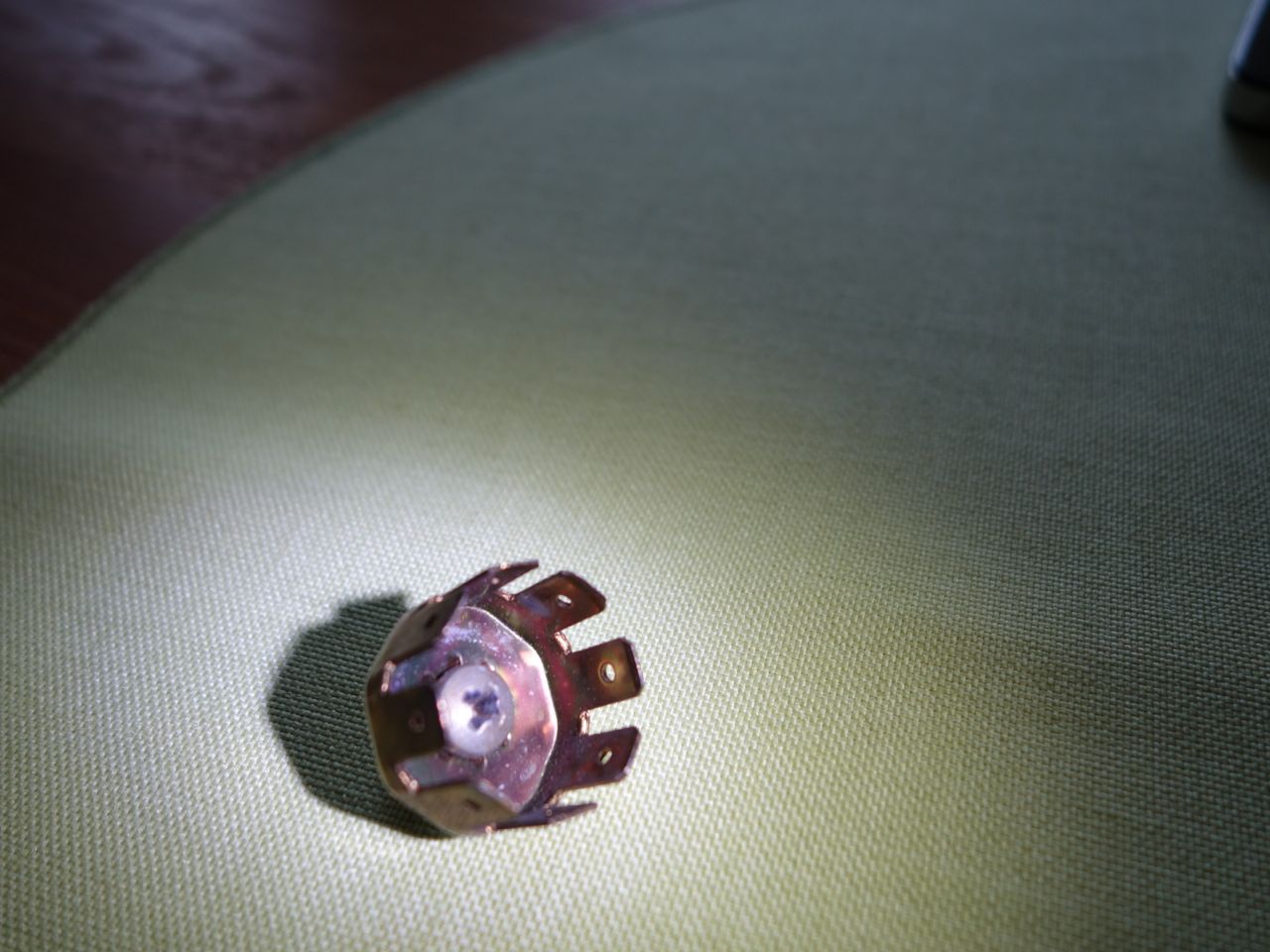

For earth distribution I will use this:
I got this from a VW mechanic.

I just could leave two slots for the fuses empty.

i agree with a single 20A, or just put 10A fuses in your 3 fuse holder. all said and done, they are there to protect your wires from burning due to a dead short. even wires not rated for 20A will survive the brief amount of time it takes for a short to blow a 20A fuse. so it isnt really a critical thing.
alexander.

I am also planning on using 1 fuse for the coil and a seperate fuse for the Mjlj and Edis module.
I am presuming a 5 Amp fuse will be fine for the Edis(4) and Megajolt but does anyone know whether a 10 Amp will be enough for the coilpack please ?
cng1
Posts: 282
Post by cng1 »
The Megajolt is low current so should be on a separate low-rated fuse, 5Amp is overkill for that really. The EDIS and coils are the bits that needs the higher current fuses. In general people connect both EDIS and coils to a single fuse, 10A should be fine on a 4-cylinder setup but with dual coils I'd probably go out to a 15Amp fuse.
