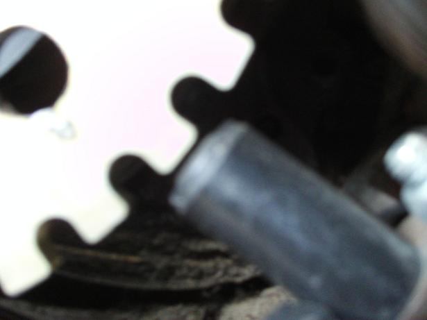

The rpm move okay up to 2500 rpm in my drive test then get all funny after that. The everything started getting erratic again.
This is video of the trigger wheel moving.
Also picture of the gap. It's abut 1mm-1.5mm
I have a feeling it might be too far. Not sure.

A smaller gap would be better, 0.75mm with a maximum runout of 0.25mm is a good target.
www.trigger-wheels.com
You will also want to look at the strength / rigidity of the bracket. If the bracket is not rigid, it will vibrate at certain RPMs and cause the EDIS module to lose synchronization with the trigger wheel.

Well I bought another vr sensor connector. Re-wired it as the previous connector turned out to be loose and this time I inserted the nylon square insert into the connector so it would not wobble.
I also at the same time made the VR sensor as close as possible to the trigger wheel .
RPM's did not lose sync in the 1 hour trial run.
I leathered it 6000-7000 rpm and it was smooth all the way through. I went over pot holes and bumps at 40-50mph and it did not lose sync.
