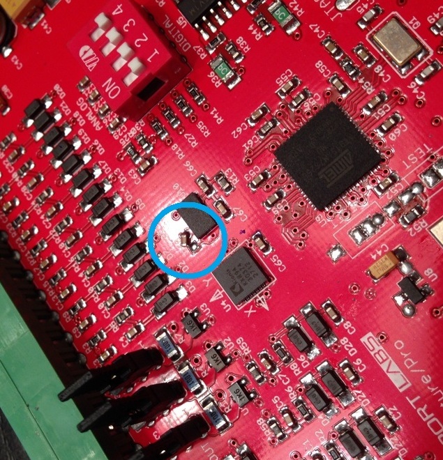

So Brent, I have a new update, I was checking on the internals and found that the capacitor at C68 was not completely connected. See the attached picture. Could this be contributing to the issues I am seeing with the frequency measurement? I tried the loopback test again and it wouldn't work this time...
- C68 in Blue Circle
- RCP-C68.JPG (227.77 KiB) Viewed 27860 times

The mis-soldered capacitor is unrelated to this issue. It is a capactior attached to the gyro sensor. It looks like an assembly defect slipped past our testing. If you can solder it, that would be good, or we can fix it for you.

The yaw sensor is working fine for now so I'll check continuity to see if it is a cold joint or not.
