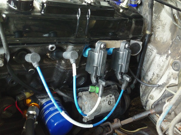

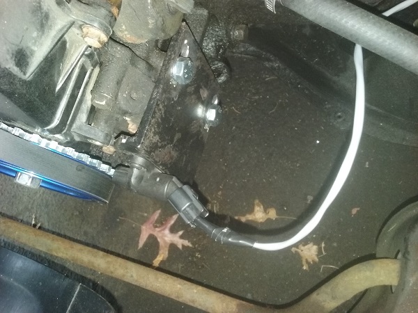

Hi guys! I own a 1984 Toyota Corolla Sport SR5 (AE86) with a 4AC that I successfully adapted Megajolt to a year ago. I used 2JZGE coils instead of the Ford coil. I couldn't find a decent place to put the Ford coil. I made it PnP with the factory distributor connector. Tach works. Trigger wheel is made by Techno Toy Tuning, mounted to their single belt pulley for a 4AGE. Carburetor is a Weber 38 DGES with an internal air horn.

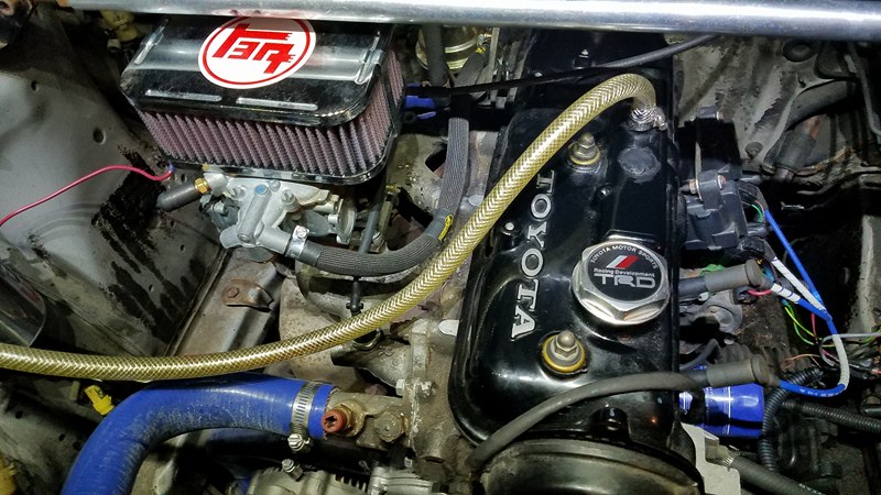

Current status of my 4AC.
2JZGE coils and wires.
SAM_0705 - Copy.JPG (243.06 KiB) Viewed 22519 times
Techno Toy Tuning 4AGE crank pulley with their Trigger wheel, Ford Escort Crank Sensor
edis2 - Copy.jpg (126.01 KiB) Viewed 22519 times
