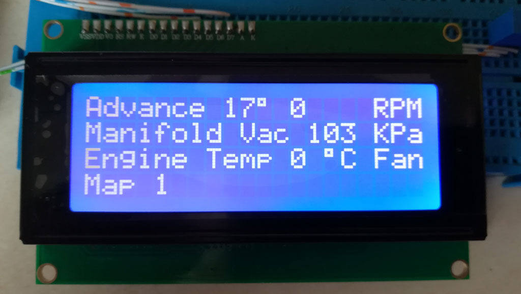

I've got this far using the $ command (0x24)
Is there a different command that brings in the aux data? I've tried S (0x53) but that doesn't seem to contain it either.
"Fan" is based on UserOut1 status as that is controlled from the aux temperature... its blank when its not running
Everything else is working just great but it's slightly frustrating that the aux data is seemingly not documented for the V3 units and nobody seems to be able to answer my question.

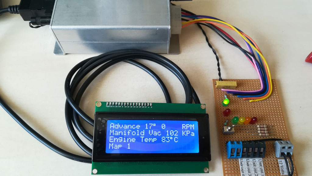

With the assistance of a serial port sniffer, I think I've cracked it.
The tuning software seems to send 's' (0x73) and receives 9 bytes
By Adjusting the pot on my test board I've noted that byte 7 changes with the temperature.
Arduino re-programmed and:
- Display_working.jpg (106.7 KiB) Viewed 69485 times
Nice work, I have been wanting to dig in more to power a display that can be read in sunlight as I use the V4 on a 32 year old Watercraft. I'd like to include other sensor data as well, so I will be watching what you are able to accomplish.
