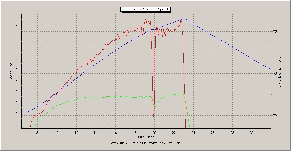

Here is my Map that I used on my 1300 xflow in a locost
3d map-locost1300.mjlj
My Map for a 1300 xflow with a GT cam, webber 40's. Everything else is standard.
Uses regular fuel
(719 Bytes) Downloaded 1147 times
Here is the performance Graph of a run down a 1/4 mile strip
x-flow 1300.jpg (128.51 KiB) Viewed 10801 times

i've been asked to set one of these up for a customer (i usually do megasquirt so i'm ok with this stuff)
so i borrowed ya map with a few changes all seams ok but were down on power compared to a when it was running a dissy only by 10 bhp or so. just wondered if u knew of any other things we can do ....?
or is this the case with mega jolt ..... lose a bit on the top end but get better driveability
